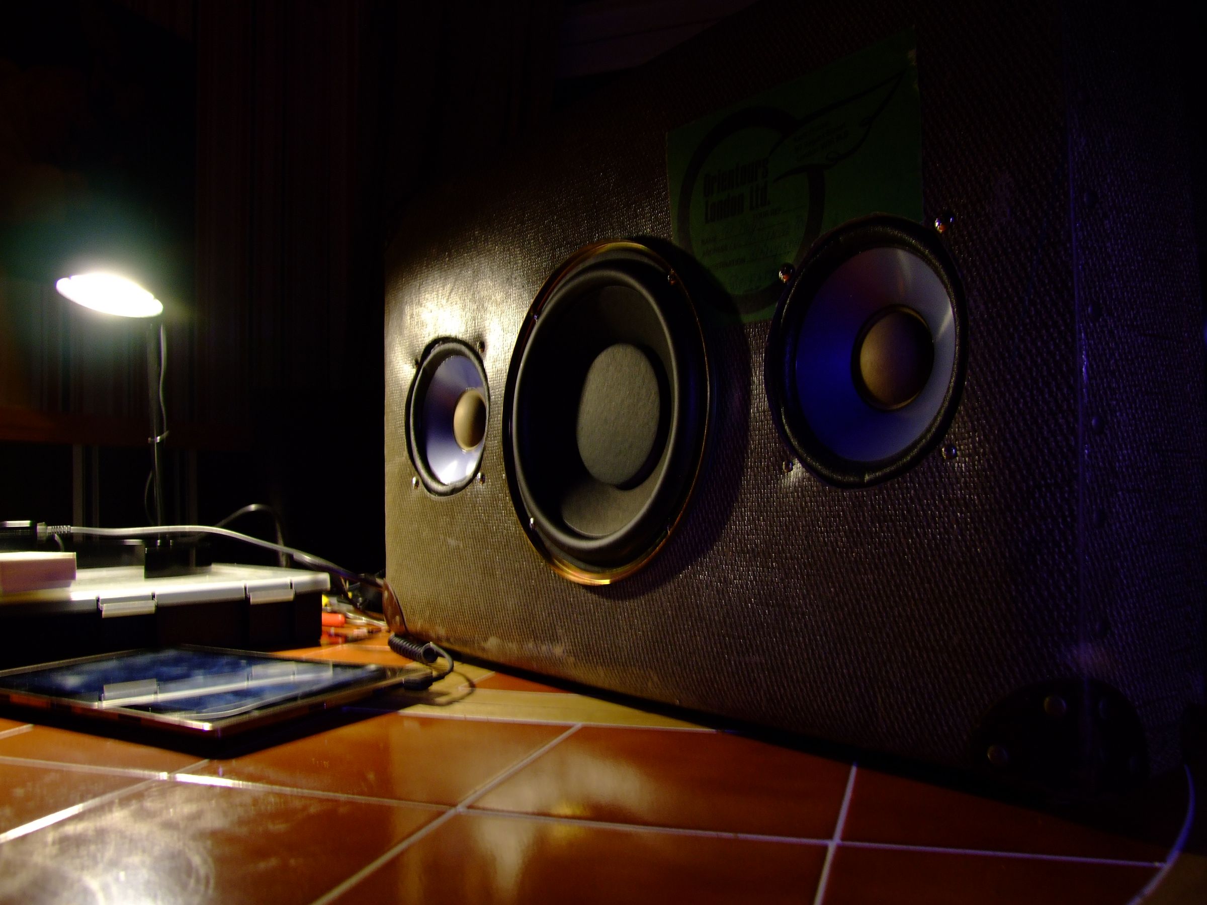

Step 7: Speakers
Before speakers were fitted, one final test had been carried out to ensure everything worked ok.
Speakers' corners had to be cut down to fit the barrel. Holes for screws were made using awl. Wires connected, and speakers fitted.
Step 8: Grilles (covers)
Step 9: Job Done!
