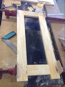

Step 4: Assembling the Side Frame
Clamp up the frame without glue to check the joints pull up tight.
Check to make sure the face of the joints are all at the same height, if they are not re cut the slots and check again.
When you are satisfied the frame will glue together neatly glue the biscuit slots and any joining surfaces touching.
Check the lower rail is at the correct height.
Gently clamp the frame together.
Check the corners are square.
Wipe off any glue.

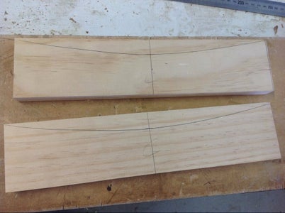

Step 5: Curved Rails
Curve the top of two long rails.
Mark a centre line on the face.
Measure down 20 mm.
Some ways to get the neat curve are;
- Use a long steel rule to get an even curve
- Draw the long rail from paper or cardboard and make a template
Use the band saw to remove the waste, keep 2 mm from line.
Clean up the curve to the line using the sander.

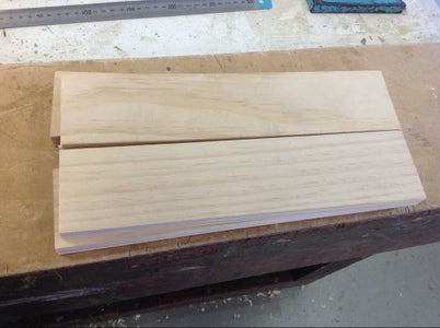

Step 6: Biscuit Joints Long Rails to Side Frames
Put the adjustable fence on the router, set the cutter height to 20 mm below the fence.
Secure the side frame in a bench vice to cut the biscuit slots
Mark the position of the long rails by marking the centre of the biscuit slots
- 55 mm then 535 mm from the top

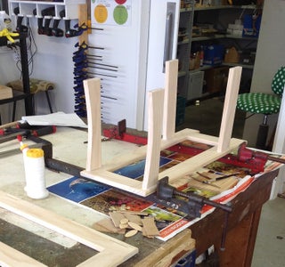

Step 8: Assemble Frame
Mark the top location of each long rail on the side frames.
- Curved rail is 20 mm
- Lower long rail is 500 mm
Assemble the two side frames together with the long rails without glue, this will allow you to make sure the joints all pull up tight.
When you are satisfied your frame will assemble neatly glue and clamp the frame together.
Check for square corners.
Remove excess glue now because it will be difficult to remove when it is dry.
