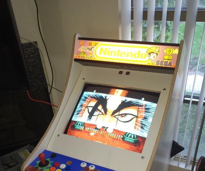

Inside is a Dell Optiplex 760 dual core 2.8GHz with 2GB RAM, 80GB HDD, 17" Dell ultra-sharp LCD display, two (2) seemingly-indestructible genuine arcade joysticks and buttons with ZERO delay or push-button response timing, high-powered stereo speakers, clear plex Street Fighter II LED illuminated marque, blue halo-accent LED illumination and everything else is built out of pre-finished white MDF board panels - the power button is wired directly to the Dell computer to keep the computer remote and out of sight, as well as the LED light strips are directly hard wired into the computer's power supply to keep extra power/cords to a minimum...
Everything is independent of MS Windows/computer interactions, including using the mouse and keyboard; EVERYTHING is programmed/wired to be a stand-alone arcade machine. Just hit the power button at the top of the machine and everything will power up straight into the Games menu; from there, you can choose a game from the list - when done playing, and to save power/energy, just hit the power button at the top again to power down the machine - THAT'S IT!

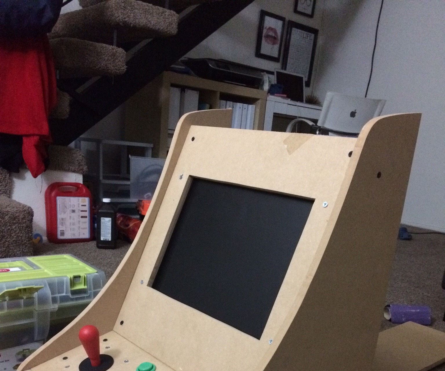

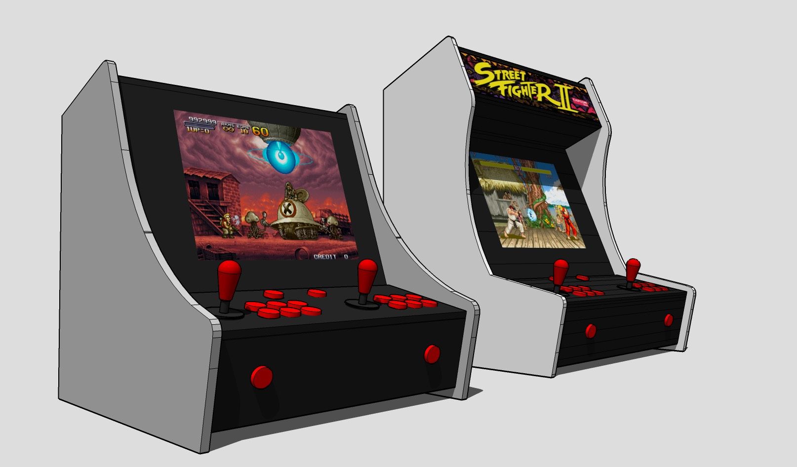

Step 1: Design, Planning & Wood-working
The design/planning/modeling was drafted with CorelDRAW and Google Sketch-Up, then printed out as patterns for wood cutting... You'll need the following to complete the project!
