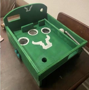

Step 1: 3D Modeling and Printing
The goal of this step was to outline the entire project. Some challenges included picking the right size of the structure to leave enough room for the mechanical components to move. I would make some changes to the model if I were to restart the project; however, this step was crucial to achieving the proper dimensions to cut the wood. I used Solidworks to design each individual part, those made of wood and those meant to be 3D printed. All these parts were incorporated into a final assembly file to display the final model. In total, only 9 parts from the assembly file were sent to be 3D printed. These parts were the LCD House, LED Box, LED Housing, Rod End, Rod Hand, Bat Bottom, Bat, Bearing Housing, and the Corner Curve.
Step 2: Wood Cutting and Painting

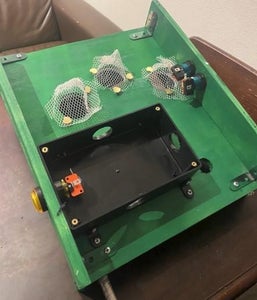

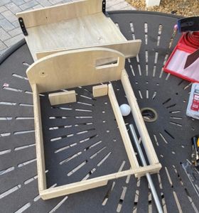

Once the model was complete, the dimensions of the main machine structure were drawn with a pencil and ruler on a 2x4 plywood. Then, a jigsaw was used in conjunction with some wood clamps to cut straight lines in the wood. The original plan was to use a laser cutter to cut the wood; however, the wood thickness of 0.5'' that I desired was too thick to use on the laser cutter available to me. When all the pieces were cut, a hole saw was used to cut necessary holes in the wood and black box. These holes are occupied by the push buttons, the flipper, the goal nets, and several passages for wiring.
All the pieces of wood were subsequently sanded and spray painted. Also, this is the step I decided to paint a design on the game to give it some life.
A hacksaw was used to trim down the length of the steel rod. This was necessary to achieve the proper center of mass for the rod. This roe will eventually be used as the plunger mechanism to launch the ball.
Step 3: Assembly of the Main Structure
This was one of the most satisfying steps of the entire project because I could visibly see the progress of the project which provided motivation to keep going. In this step, a drill with screws was used to create the outer frame of the playing field. Then, wood glue was used to attach the backboard, as well as, the inner passageways of the ball. Finally, corner brackets were used to mount the black box below the field, as well as, the two wooden panels that house the push buttons.
In this step, I also mounted most of the 3D printed parts using glue: corner curve, LED housing, LCD housing, Plunger grip, and Plunger cap. The Flipper assembly was also mounted. This was done by placing a ball bearing in a 3D printed housing and using screws to attach the bearing to the bottom of the field. The Bat Bottom was then run through the bearing. The piece protruding to the top of the field was then glued to the actual flipper. A bearing assembly was used to minimize the energy lost to friction as the flipper is being actuated.

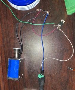

Solenoid:
  • Tools: MOSFET, Diode, Solenoid, Universal AC Adapter with green terminals, Female-to-Male wires, Soldering Iron
  • I wanted this circuit to be independent of the breadboard setup due to the high current the solenoid required for powering. This required the use of a soldering iron to attach the MOSFET and Diode terminals to the wiring needed for the circuit. A flyback diode was used to avoid any damages that could be caused to the Arduino from an induced EMF from the solenoid when its current is interrupted. The MOSFET was used to ensure that the solenoid is only actuated when a digital pin (pin 53) from the Arduino is set to high.
