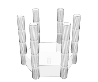

Step 1: Creating the 3D Printed Baseball and Stand
The files for the baseball and the stand are attached below and ready to be printed on a 3D printer. You will need both to create this project yourself. The baseball needs to be printed with a diameter of 3 inches (which is the diameter of a real baseball) and the stand has to be the same.These can be printed out of any color material you would like. After the ball and stand have been created in the printer make sure to take sandpaper and remove all of the supports. This is a slow processes because you don't and to break off any of the laces but it will give you a very nice looking product. The box located under the ball was provided by the make course at the University of South Florida and can be replaced with any box size big enough to hold and arduino and and a breadboard for the circuit.If you go to makecourse.com you can find the exact box dimensions and a file to use with the 3D printer.
