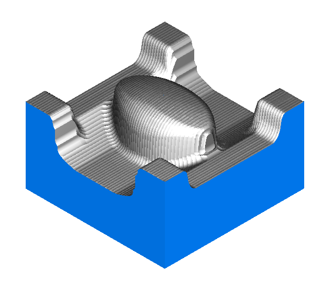

Notice the small areas not touched by the finishing operation in the lower curved corners. This is due to tool selection. By default all surface milling operations select a 0.5" end mill. This default behavior can always be changed in the Machining Attributes. In this case, the curvature of the 0.5" ball end mill is simply not small enough to machine the desired contour, and a smaller tool will be required.
  • Create a new 0.25" ball end mill for the Parallel Finishing operation
    • srf_mill2
    • finish1
    • Tools tab
    • Create a new tool
    • Copy the dimensions as shown below, and activate the new tool
  • Run a 3D Simulation

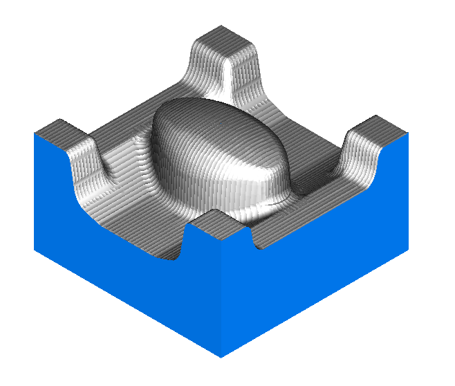

Now that we have fixed that issue, it's time to take a look at surface finish. Notice how the finish on the corners along the x-axis look good, but the finish along the y-axis leaves large scallops. This is because we are going an X-Parallel operation. Any surfaces where the tool is machining along the slope will look fine, but machining across slopes will leave larger scallops.
  • Add a perpendicular remachining pass to the Parallel Finishing operation
    • srf_mill2
    • parallel
    • Strategy
    • Check 'Add perpendicular remachining pass'
Notice how much better the finish is on the corners of the model.
  • Decrease the finish stepover to 0.005" to further improve surface finish, and run a 3D simulation
Notice how improved the surface finish is now! While the finish is much better, if you navigate to the details tab of the results window, you will notice that this part now takes roughly an hour to machine. You will want to consider machining time when modifying attributes such as stepover, and choose the value that best suits your project's needs (surface finish vs. time, etc.)
