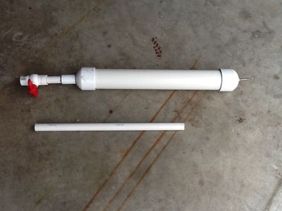

Step 1: Build End Caps
After you have gathered all of your supplies, and collected your thoughts, you need to start somewhere. This might be one of the hardest steps, be sure to revisit some of the pictures and look at other designs if you get confused!
Here we go!
Start by drilling a hole strait through the middle of one of the end caps to fit the Schrader valve, try to find a drill bit that makes the smallest possible hole to fit the valve, and use a drill press if possible! After your hole has been drilled, prime the inside of the hole with PVC primer and poke the valve through to make sure it fits. When you are absolutely certain you have done everything right, put PVC glue between the valve and the end cap hole so that it makes a tight seal. You want the end cap to be airtight!
Once you have done that, take your second end cap and cut a much larger hole in that to fit the 0.5 in. pipe. Be careful to make the hole exactly correct because you don't want it to leak! When you have cut the hole, cut about 5 in. of pipe off of the 0.5 in. wide piece of PVC. This piece will connect the pressure chamber to the dump valve. Glue the pipe to the end cap hole! You can breathe, it is all easy from here! (well...)
Step 2: Build the Pressure Chamber
Take a short break.
Alright, now we will finish up the pressure chamber and move on!
First, get the end cap that has the tube sticking out (not the bike valve one) and glue the dump valve to the end as shown in the pictures. Now you should have an end cap with a bike valve sticking out and an end cap with the red (or other colored) sticking out.
Glue the completed end caps to the 2 in. wide PVC pipe so it looks like the pressure chamber in the pictures.
You're almost done!
Step 3: Add the Barrel
You can make the barrel as long as you want, keeping in mind that with increased length, comes increased friction, and loss of power. :( If you make the barrel too short however, you lose accuracy.
Do not worry about gluing the barrel to the dump valve, as long as the barrel doesn't fall out. It is also much easier to load if you can detach the barrel.
With the barrel in place, you are done! Almost...
Just let the glue dry for a few minutes if you haven't already.
