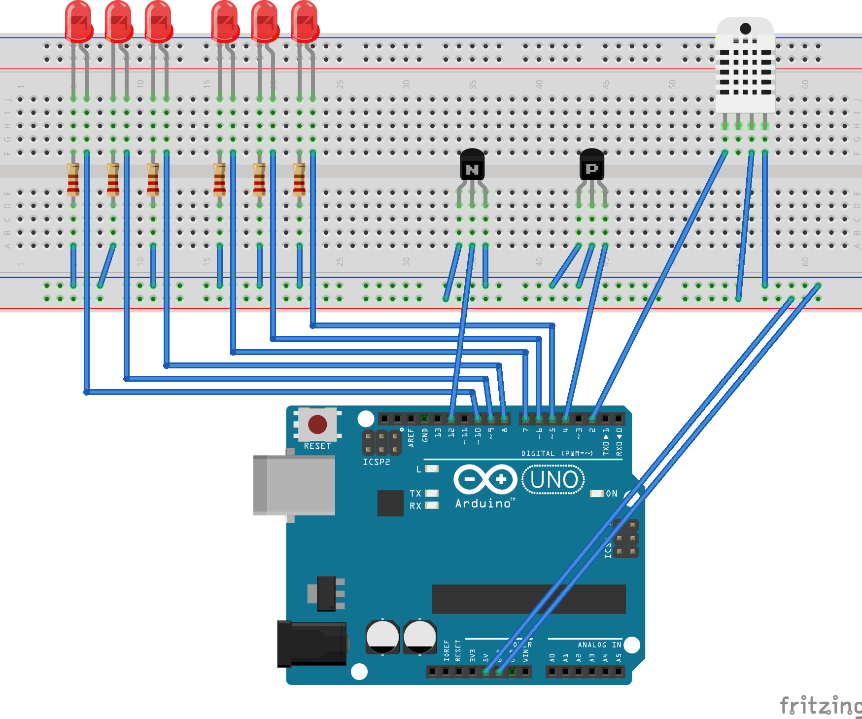

Step 1: Single LED Connection
- Add a single red LED to the breadboard
- Connect (+) leg of LED to pin 8 on Arduino
- Connect (-) leg on LED to 220 ohm resistor to Ground on breadboard
Step 2: Connect Yellow and Green LEDs
Connect Yellow and Green LEDs as in the previous step
- Yellow to pin 9
- Green to pin 10
Step 3: Connect LEDs for Second Traffic Light Group
Connect the second set of LEDs as the previous steps
- Red to pin 11
- Yellow to pin 12
- Green to pin 13
Step 4: Connect Button
Add button to center of breadboard
- Connect bottom left with 1 Mohm resistor to ground
- Connect bottom right to power rail on breadboard
- Connect top left to pin 2 on Arduino
*pin 2 or 3 are required for interrupts on Arduino UNO
Step 5: Finish Circuit
Connect 5v and Ground from breadboard rails to Arduino
