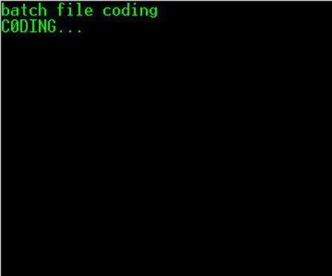

Introduction: Basic Batch Command List
Echo off (Stops displaying c:> before every line of code displayed in the command prompt.)
Example:Stops displaying c:>
Echo off
Echo (Displays a message on the command prompt.)
Example: Displays "Hello world".
Echo Hello world!
Title (Sets the the command prompt title.)
Example: The title is now "Greeting the world".
Title Greeting the world
Cls (Clears all text above and does not display Cls)
Example: Displays "Hello world" then Displays "Bye" With nothing above Bye.)
Echo Hello world Cls Echo Bye
Pause (Pauses the code until a key on the keyboard is pressed and displays " Press any key to continue...".
Example:
Echo Hello world Pause echo Bye
Color (Sets the color of the text and background. The first digit is the background the second digit is the text.)
Example: 0 is the background A is the text.
Color 0A
Set (Sets a variable.)
Example: "Name" now equals "Bob".
Set Name=Bob
If (Condition for a variable.)
Example: If the variable "Name" is equal to Bob then it will display "Welcome, Bob" on the command prompt.
If %name%==Bob Echo Welcome, Bob
If not (Condition for a variable.)
Example: If the variable "Name" is NOT equal to Bob then it will display "Your not Bob" on the command prompt.
If not %Name%==Bob echo Your not Bob
Exit (Closes the command prompt)
Example: Closes the command prompt after the pause.
Echo Hello world pause cls Echo Bye pause exit
: (A series of code title)
Example: The class is called "Start" and executes all the commands below it.
:Start Echo off Title Are you Bob? Color 0A Set Name=Bob If %Name%==Bob echo Welcome, Bob If not %Name%==Bob echo Your not Bob Pause Cls Echo Bye Pause exit
Set /a (Sets a variable with a math equation.)
Example: The variable "Number" equals 2.
Set /a Number=1 + 1
Set /p (Asks for user input.)
Example: Displays "What is your name:" and the variable "Name" set to equal whatever you type into the command prompt.)
Set /p Name=What is your name:
Start (Will open a program on your computer or open a Link)
Example 1: Opens up Google Chrome the program.
Start Chrome.exe
Example 2: Opens the link to instructables the web site you are on right NOW.
Start "https://www.instructables.com/"
