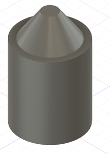

I started with the pre-made pieces supplied for the class and assembled that together to create the base of the design. I then decided that my motion would represent clay 3D printing- a tube that goes vertically up and down representing the nozzle and an open cylinder spinning representing that piece being printed. I modeled these seperatly, as well as the rotating shapes which would cause this motion. Lastly, I extruded out parts of the pieces that had large flat areas to save on material and reduce printing time.
