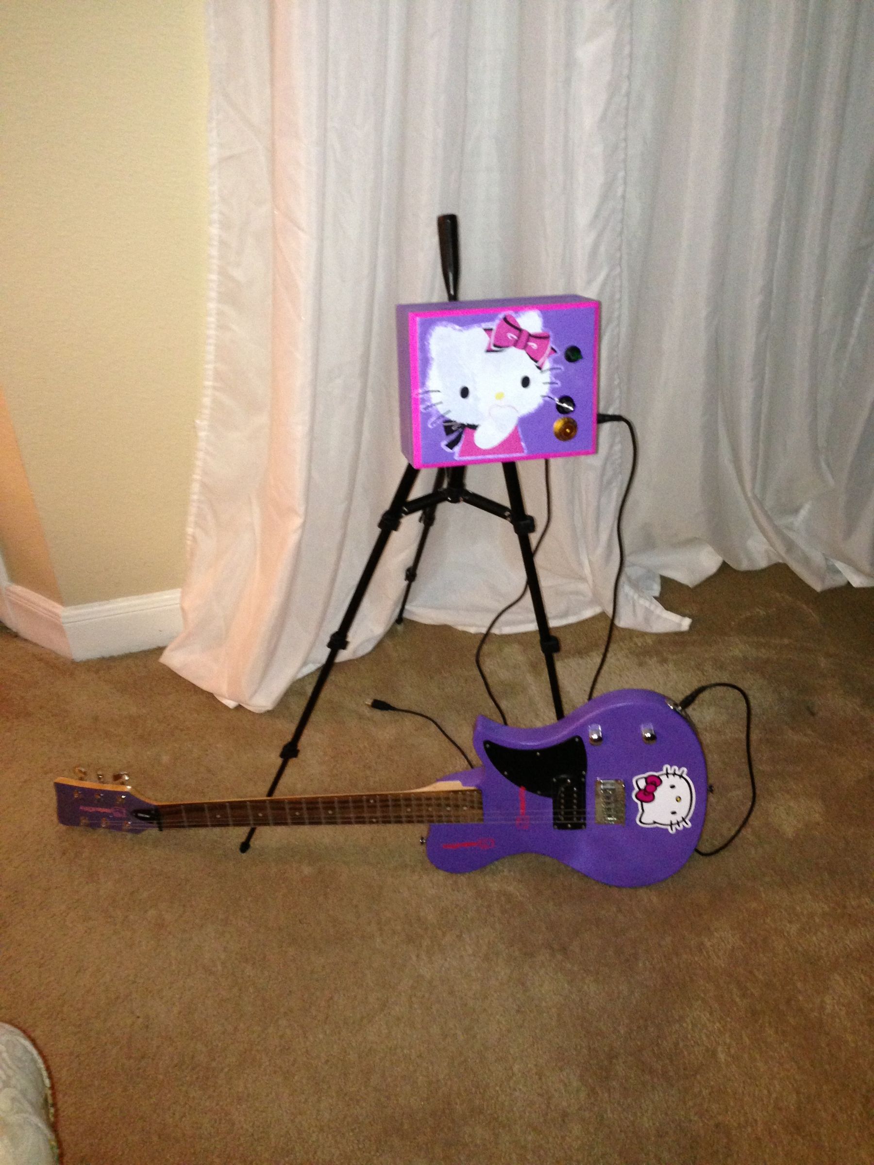

This is the 2nd tripod guitar amp I have made. I will use a basic amp - but with a twist; using old and new parts.
Step 1: Tripod Stand
Find a tripod stand, you can use a game system stand, camera stand, speaker stand, etc...
Step 2: Cigar Box
Look for a cigar box. I try it out first, will it hold all my parts? Will the speaker fit??
Step 3: Mount Your Tripod Stand to Your Cigar Box.
Un-screw the back of the tripod mount. Take the springs out & plastic pins that hold the stand onto the game system ( if you use a camera stand then look for a bolt/nut to hold it into place ). Mark the spot that you would like to mount the stand with a pencil ( you can erase the marks or light sand them off later ). Then drill out the holes - mark them with a screw setter. Drill out the plastic holder holes if you plan on using bigger screws to hold it into place...
Step 4: Continued - Mount Your Tripod Stand to Cigar Box.
I need this stand to hold the weight of the cigar box amp. Continue to mark all your holes & drill them out. I'm not taking off the plastic pins at the left or right side, so I need to drill out holes to hold them into place. Find some long screws ( 4 of them ) to hold the part into place. Then press down with your fingers. This will leave marks onto your cigar box on where to drill out your 4 holes for the plastic mounting pins. Then take off all stickers, and sand the plastic mount & the cigar box ( stay inside the holes for the screws ). Do not sand more than the top layer.
Step 5: Add Glue & Water.
Go ahead and erase all marks or light sand them off. Now mount the plastic plate to your cigar box. Use a glue that will bond to plastic and wood. Spread out the glue on one side and water onto the other side ( make sure not to use too much glue - It will leak over the sides and make a mess ). Use the screws to hold it Into place. And use a weight to help hold it tell the glue sets.

I never finished this amp - might do it by next year, but wanted to up load the pictures in case someone wanted to make one. I just need to add the wires to the amp.
Step 11: Amp
You can use just about anything to make this amp.
