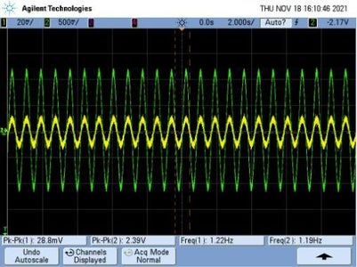

Step 1: Create the Instrumental Amplifier
Create the instrumental amplifier in LTspice according to the schematic that is shown. This will be able to be verified if the output of the instrumental amplifier has a gain of 100 with a 20mV input simulation in the voltage source. Once this is complete, obtain a breadboard, 7 18kꭥ resistors, a 330ꭥ resistor, and 3 LM741/NS op-amps, and various jumper wires. Refer to the pin diagram and the schematic to build the circuit.
This can be verified using a function generator outputting a 20mV peak to peak sin wave hooked up to an oscilloscope. The oscilloscope peak to peak amplitude should be 2V. As shown.

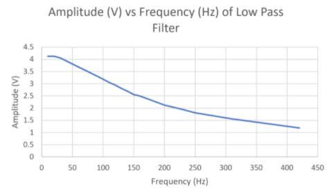

Step 2: Create the Low Pass Filter
Create a low pass filter in LTspice according to the schematic that is shown. This will be able to be verified if a 1V AC sweep from 1Hz to 200Hz of the low pass filter has a cutoff frequency of 150Hz in the LTspice simulation. Once this is complete, obtain a breadboard, a 15kꭥ resistor, a 47kꭥ resistor, a 0.035uF capacitor, a 0.068uF capacitor, an LM741/NS op-amp, and various jumper wires. Refer to the pin diagram and the schematic to build the circuit.
This can be verified using a function generator to various frequencies at a constant amplitude hooked up to an oscilloscope. The oscilloscope should show a drop in amplitude after 150 Hz.

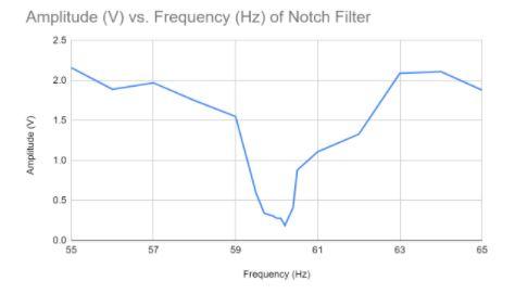

Step 3: Create the Band Reject Filter
Create a band-reject filter in LTspice according to the schematic that is shown. This will be able to be verified if a 1V AC sweep from 50Hz to 70Hz of the band-reject filter has a cutoff frequency of ~60Hz in the LTspice simulation. Once this is complete, obtain a breadboard, 2 1.5kꭥ resistors, a 490kꭥ resistor, 2 0.1uF capacitors, a 0.2uF capacitor, an LM741/NS op-amp, and various jumper wires. Refer to the pin diagram and the schematic to build the circuit.
This can be verified using a function generator to various frequencies at a constant amplitude hooked up to an oscilloscope. The oscilloscope should show a sharp drop in amplitude around 60 Hz.
