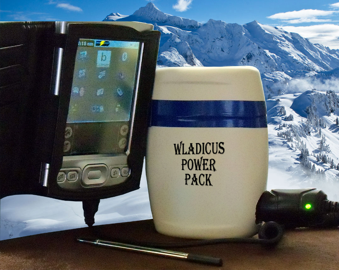

Step 8:
This photo is just a reminder of the project that used the cigarette lighter socket for which electric continuity was tested in the previous step in this instructable.
The following note is extra information for those who are curious about how cigarette lighter plugs and sockets are wired.
Note: sometimes the negative wire is identified by some sort of marking such as a white stripe.  In this case, the socket wires actually had one wire casing with a slightly 'grooved' surface.  However, to be absolutely certain that this was the negative and not the positive wire, I tested the continuity.
The following is general information on cables that plug into a car's cigarette lighter socket:
1. They are usually designed to accept power from a 6 volt  or 9 volt car battery.  Thus the plugs are often designed with built-in circuitry to handle a range of voltages from 6 to 12 volts.  However, there can be plugs specifically designed  for one particular voltage only, so take care to read the spec sheet or manufacturer packaging information in every case.
2.  The tip of the plug is usually designated as the positive terminal and it makes contact with the positive plate at the back of the female cigarette lighter socket.
3.  The two springy contacts on the outside of the plug contact the inside metal ring of the female socket and are generally connected to the negative electrical terminal.
In  2 and 3 above, in rare cases it could be that the wiring is opposite, but I have never encountered this.  Therefore, electric continuity testing can be useful in many situations.
