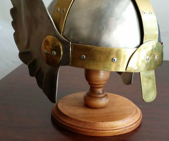

Step 3: Cut the Sheet Metal
Trace out the brow, ribs, and dome onto the brass sheet metal and another dome on the stainless steel sheet metal using the marker. Trace the pieces next to each other so you save on materials. It might be easier to cut the ribs out as one piece so they're easier to roll and grind, then cut them into two pieces after they're rolled.
Cut the sheet metal with the Beverly shears.
Grind down the edges of the pieces with the grinder or sander. You'll need to shape the piece to fit the trace, and remove any burrs from the edges so you don't cut yourself while working with them later (or wearing them on your head).

Step 4: Roll the Pieces
Using the electric slip roller, roll the brow, ribs, and spine. Start with a shallow roll, making two passes (once in each direction) for each piece before tightening the roller, this is to create a consistent roll on both ends.
Keep tightening, one inch at a time for each round of passes, until the brow goes all the way around in a circle. At that tightness, the spine will be a half circle, and the ribs will be quarter circles. Towards the end, you'll need to pop the roller off to get the piece into the roller because the circle will be so tight it won't slide into the top of the roller anymore.

Step 5: Dish the Domes
Using the armoring swage or leather sandbag hammer the brass and steel circles into domes with the plastic mallet. You'll need to fit the dome to the curve of the ribs and spine, so fit the dome to them often while you're working to get the fit right. If you dish too deeply, you'll need to pound them back flat with the plastic mallet on the table or anvil of a vice.

Step 7: Assemble and Fit the Frame
Finally! You can bolt all the pieces using the temporary rivets (i.e. the #6-32 screws and wing nuts). The wing nuts go outside the frame so you can fit the frame on your head without stabbing your scalp.
The bottom dome holds the ribs and spine together and the top dome hides the joinery of the ribs and spine and holds the decorations of the finished helmets (like spikes, feathers, etc).
After bolted together, press sides of the frame into an oval to fit your head. Bend the nose piece up so it doesn't press on your nose.
You're done with the frame!
In later tutorials we'll cover how to add leather or steel plates, decorations, and permanent rivets.
