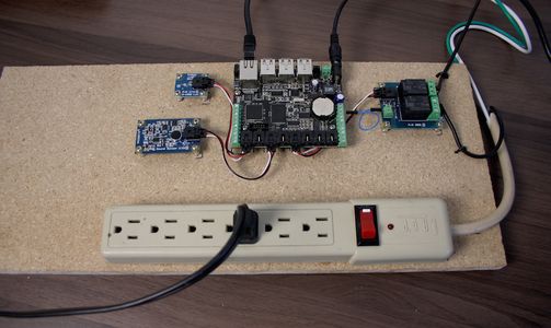

To start off, get a plate of wood or metal in the approximate size you want your panel and mount the SBC, sound sensor and indoor light sensor to it. If you want to eventually add more sensors, prepare a larger board so you have room to mount everything. Use the stand-offs provided with all the Phidgets so that there is adequate spacing between the Phidget and the surface of the panel. This is especially important if you are making your panel out of metal; If the electronics touch the panel you are bound to have numerous short circuits.

For the light, we hacked apart the cord of a power bar. An extension cord will work the same way, so you can use that instead. While the power bar is unplugged, strip the outer coating off about 6-inches of the cord coming out of the power bar. There are three wires (black is the load, white is neutral and green is ground). We want to work with the load line, so cut the black wire and strip just an ⅛-inch off the ends to reveal copper wire.
Connect one of the stripped black wire ends to 0C (0’s common) and the other end to NO (normally open) on the dual relay board.
[Edit: A reader suggested adding a fuse in series with the output of the relay. Choose a fuse that's rated equal or lower to the contact rating of your relay. A very good suggestion!]
Connect the dual relay board to the SBC: Connect control 0 on the dual relay board to digital output 0 on the SBC using a piece of wire (the number correlation is arbitrary and we could connect this wire to any digital output). Connect the sensor cable to analog input 4 (this is just for power).
Plug any standard lamp you wish to control into the prepared power bar or extension cord. Make sure the light’s switch is in the “on” position.
Of course, you can put other things into the power bar, but they will only work when the power is on (as in, the digital output 0 on the SBC is on). Different electronics function differently, so it may only mean power is going to it, but not turning it on. Lights are pretty simple so they function well. Also, you won’t be able to control each device individually. You could repeat the process with another cord and attach it in a similar way to the other control on the dual relay board.

Attach the indoor light sensor and sound sensor to analog inputs 0 and 2, respectively, using sensor cables. You can attach the sensors to different inputs, but you’ll need to change the code, so start here.

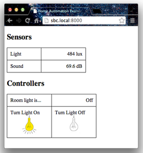

Index.html is the face of the program… like most web-pages, you know how it works.
We use jquery and some very simple css. The jquery file is available online and in the source files for this project. style.css is pretty basic so it won’t be explained here, but feel free to play around with it or use your own stylesheet. You can check out a CSS tutorial on W3 Schools.
Setting Up The Ajax Requests
We start out with some javascript that sets the interval for data requests of the SBC through Ajax. All the sensors will need to be loaded right away and then checked periodically. You can set different sensors to have different intervals by putting them in different setInterval methods and changing the second parameter to be the number of milliseconds you want between data requests. Make sure to give all your sensors a unique and descriptive name. Note that in this example we’re also going to be sensing whether our light attached to the SBC is on or off.
We also have elements with the IDs “light1On” and “light1Off” that, when clicked, we want to send a request through Ajax to the SBC. We set the onclick functionality here. Each element (button or image or whatever you want to cause the output to change) will need its own unique and descriptive ID.

The Webpage Finally, the body. The table cells where we want the sensor values to be displayed are given the ids we just used in setting up the ajax requests. This makes it so that their content is updated with each new get_data request, described a bit earlier.
Also, the table cells that we want to use to control the lights are given the appropriate ids (“light1On” and “light1Off”) so that when they are clicked the onclick function sends the Ajax request.
You can add more table rows for different sensors, giving the cell where you want your data displayed the id you chose (like “temperature”, if you had a temperature sensor).

Go to the SBC web interface. Go to projects and click the home automation project. In startup settings, choose the homeautomation executable and set it to enabled. Save changes.
There will now be a Start button at the top. When you click it, the program should start running. Bring up http://mcflysbc.local:8000 (you will need to replace mcflysbc with whatever name y ou've given to your Sbc) to see the input and control the light.

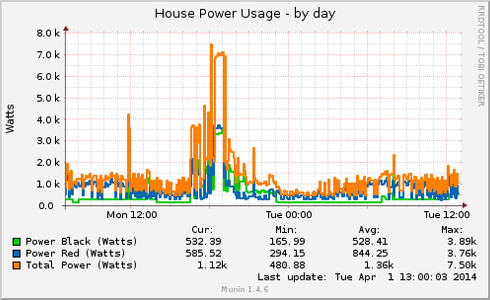

Next up, you can keep graphs of the data collected so you can look at trends over the year. You can also switch the server to a world wide web address so that you can access it anywhere. The SBC supports any USB Video Class (UVC) webcam, so you can set that up too.
You can do all sorts of things with sensors:
- Detect motion
- Monitor temperature and humidity of greenhouse plants, garages or anything
- Keep track of open and closed doors (with magnetic sensors)
- Monitor supplies like toilet paper or laundry (with load cells functioning as a scale)
- Voltage and current sensors for measuring your house’s power consumption
