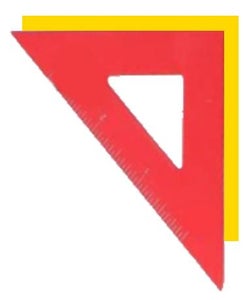

Ever see that triangular plastic thingamajig that comes in a geometry kit? You know, the one included with the mini pencil and the compass? Many of us never learn what that thingamajig is, let alone what it does. We might venture so far as to use it as a ruler, or a straight edge-- or we might just give it a funny look and chuck it in the back of the 'forget me' drawer. Well, go open that drawer, fish around past the gummy glue sticks, the mound of markers, the lost batteries, and that one screwdriver you blamed your roommate for losing. Find the thingamajig?
That triangle is a square.
"What!?" you exclaim in surprise. "It can't be!"
Trust me on this. It's a square.
"No way! I know my shapes. Three sides is a triangle."
Nope. Square.
"Aw! Go feel your head! Are you saying my beloved kindergarten teacher was wrong?"
Whoa! Easy there. That triangle in your hands (yes, the one you are thinking about using on me) is a handy-dandy, truly amazing, and yet refreshingly simple device for MAKING things square. Because of this, we have dubbed it a 'square'. Probably because it is a lot easier than calling it 'that cool triangular thingamajig for making lines and angles'.
