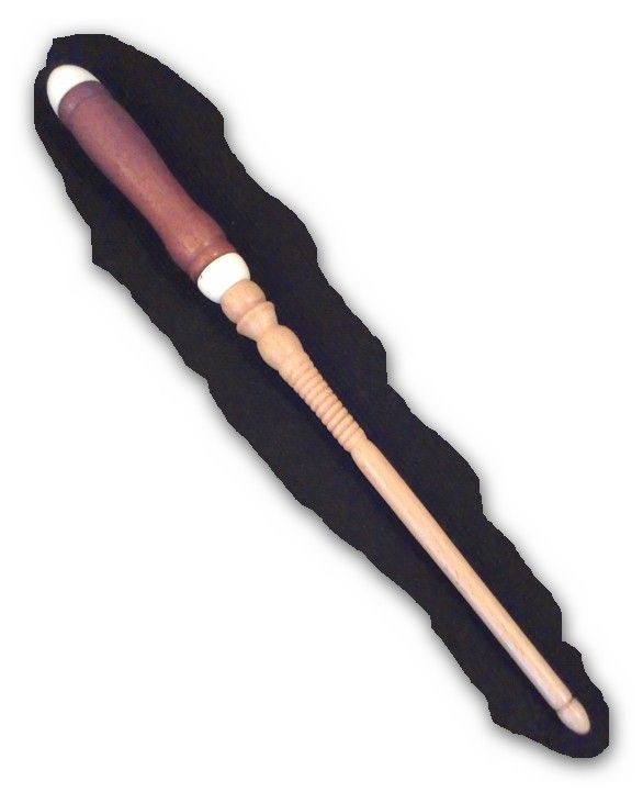

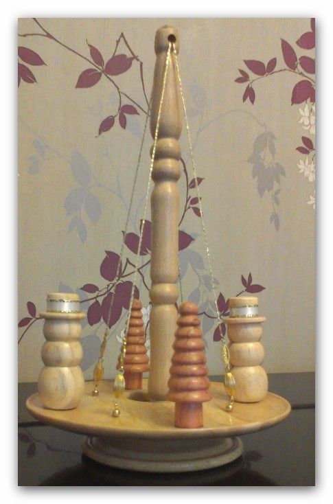

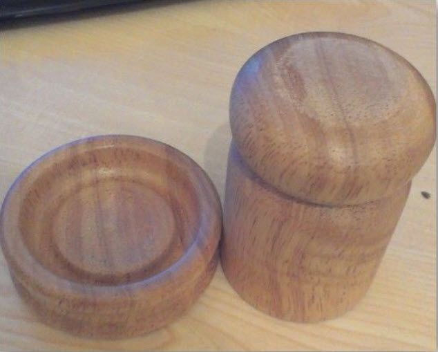

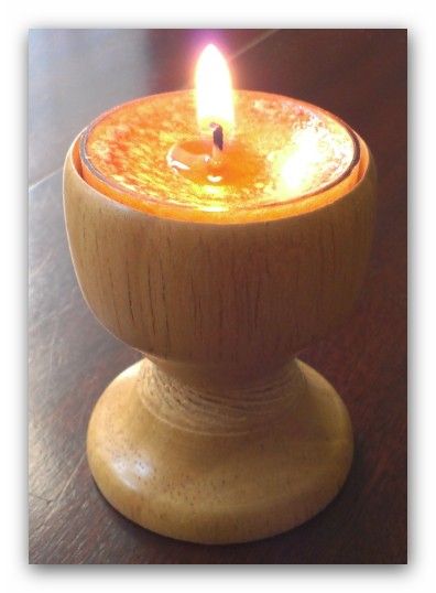

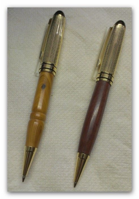

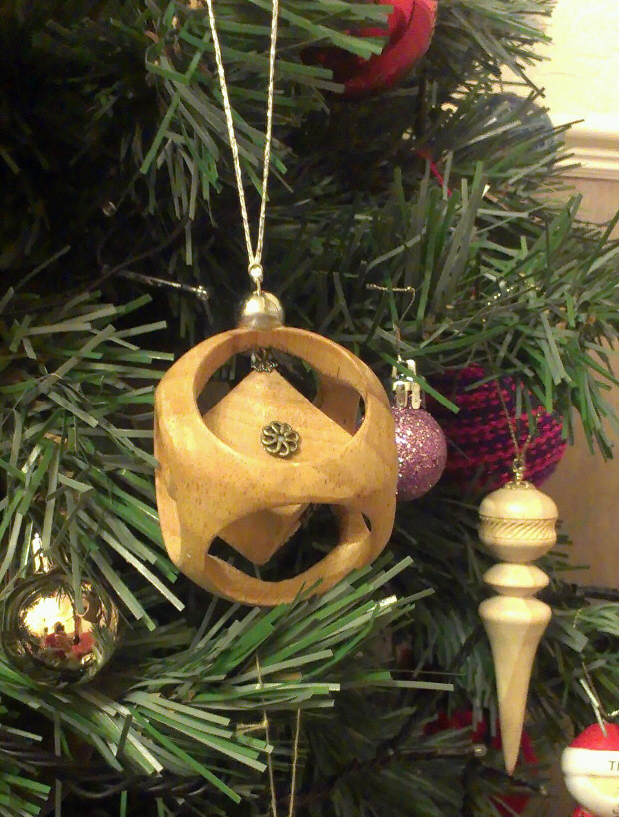

The pictures above are examples of the kinds of things you can make as gifts from wood or other materials using a lathe

For pens I sometimes apply supper glue to wood pen barrels and polish using the pen pads(see the images above) the combination gives a fantastic finish if you get it right.
