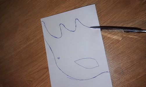

- Fold the paper in half

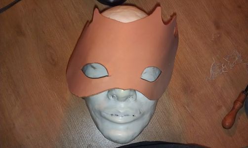

- Working "in from the fold" draw an eye shape, starting about 3/4" in from the fold. The eye should be a couple inches long. mine are 2.25" long and 1 inch high.
- Next, draw one half of the mask. you can start with a basic shape, or go for something with a little dimension. this is all about trial and error, experimenting and improving. start simple, and add on as you make the next, and the next.

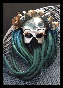

- Keep that nose and bottom cheek line fairly close to the eyeline. since this is just a halfmask, you are going to want it to come up a bit at the nose, like in the 3rd photo. this makes it easy to fit many faces, and more comfortable to breathe in.

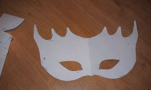

Step 3: Cut Out Your Template

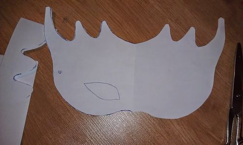

Cutting from the fold line, keep both sides together and cut around your lines. Remember, you can always trim off and slim things down, so going a bit oversize is better then needing to add on (and restart the pattern)
- Cut out the basic pattern, keeping the 2 halves together while you cut on the lines
- Unfold and cut out the 1st drawn eye.
- Fold together again and draw the line for the 2nd eye, following the hole you just cut
- Unfold and cut 2nd eye.
Your Template is complete!

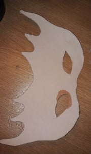

Step 5: Cut Out Your Leather Mask!
Taking care, cut out the leather with your scissors. Sometimes it can be helpful to very lightly mist the flesh side with water *spray bottle* but be careful not to saturate the leather, as it will distort if you pull/push while cutting!
Once the outside is cut, you will have to cut out the eye holes. It helps to wet the area you will be cutting, but again, take care not to overcut,mark up or stretch out the holes as you cut. Some people prefer an x-acto or similar tool for this.
I find using scissors works best for me with this Oz/thickness of leather. If I am using thicker leather its about 50/50 x-acto to scissor ratio personally. If you wet the leather (just the eyehole) then lightly fold the mask, then snip a starter slit in the center of the eye, it is much easier to get your scissor right on the line and make a nice edge.

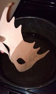

Step 6: Wetting Your Leather (without Cooking It!)
Get a pot ( I use a cheap enamel one that is NEVER used for food) and put a good amount of water in, alternately if you have no pots that are suitable, you can use your sink, if you run the hot water to the point where its steaming and as hot as it will go- then plug up the basin and let it fill. It really important that the water be as hot as you can stand, but NOT SCALDING/BOILING.
Ok, this is super important. DO. NOT. OVERHEAT.
*Ideal temp is 120*
If your pot o' water is boiling, you are going to boil that leather. Leather is just skin, so if the water would burn your hand, it's going to be too hot for leather.
It is better to err on the side of caution, hot water is best, but you can do with room temp water if you want to - it just takes longer to dry and is a less rigid final product.
- Once you have your hot(but not scalding) water, place your mask (part or all if it fits) with the fleshy/fuzzy side up and let it soak some water! it will bubble and make noises and all that fun stuff.
- After about 20 -60 seconds, the bubbling should be minimal, pull that mask out and plop it on the face/headform with the GRAIN(Smooth top) side facing you.
On to molding and shaping the leather!
Step 7: Shaping/Molding
This is the creative part, and sometime it can be frustrating, but just keep at it and you'll see results. Think of the wet leather as clay (kinda) if you push, or pull or stretch it, it effects the fibers and shapes it if you are persistent. You have about 10 min of good working/shaping time. Each piece of leather is different tho- and working times may vary.
Be wary of your nails, you can mark up the grain side while you pinch and pull. Just a heads up!
- After the wet mask is on the face form, start at the nose/eye area and work your way out.
- Push the leather in to the crease, and pull the leather up for areas that you want ridges formed.
- Pinch and push and squeeze to make brow ridges, eyelids, nose bridge and such.
- Be creative! if your mask has dangley bits, pull on them or twist them and roll them up.
- Be persistent. sometimes the leather doesn't want to do what you want it to do. keep going back to the problem area, and re-twisting or pinching, as the leather dries you will notice it stiffen and hold its shape better.
- As it is drying, it is the perfect time to refine detail, but lay off trying to make major changes.
- Let it dry over night. you can use an oven at a very low temp(under 160) to "bake" a semi dry mask, but if these are your first masks, its really best to just let them dry on their own!
