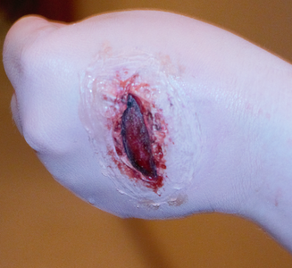

Step 8: Cut It Open
Once it is as raised as you'd like, cut the center of the latex open. Make sure you don't cut your skin! I used a toothpick and scissors to get the job done. At this step you can peel flaps back, stretch it open, or make all kinds of little holes. Whatever you desire to make it the wound you want.
For a bit more advanced measures, you can also add another layer of latex and toilet paper inside the hole. That will make for a textured inside- like an unclean cut. Add as much texture as you'd like!
Step 9: Begin to Color the Inside Red
Take your color makeup and paintbrush and color the inside of the cut red.
Step 10: Detail the Inside
Especially around the edges, add definition with black to make the cut obvious. You can now add other colored makeup if you wish. A bit of green and yellow can make for gangrene in there.
Step 11: Blend the Prosthetic In
Use the makeup that matches your skin tone to color the skin part of your latex. Paint it in or rub with fingers. Make sure the edges are nice and have a smooth transition into your skin. It should blend in nicely now.
Step 12: Add Fake Blood and Detail
Now is the time to add some drops of fake blood. Try to flick or sponge a bit around the edges for a splatter effect. Mm, gooey.
Step 13: Your Cut Is Complete!
Your cut is now complete! Use it to freak out your friends and passersby!
