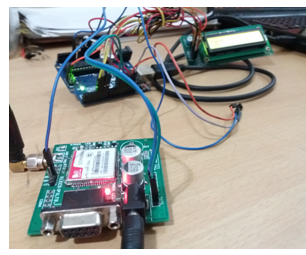

Step 1: Making Hardware Connections-
A-Connections of GSM shield &Arduino:-
1. GND of Shield-GND of Arduino.
2. Tx of Shield-Pin 10(Rx of Software Serial) of Arduino.
3. Rx of Shield-Pin 11(Tx of Software Serial) of Arduino.
B-Connections of Matrix Keypad & Arduino:-
As shown in figure
C-Connections of LCD & Arduino:-
As shown in figure
