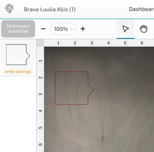

Step 7: Cutting Out the Model
Go to app.glowforge.com. Sign in. (If you do not have a laser cutter, you'll have to order one, sorry.) Import your SVG file.

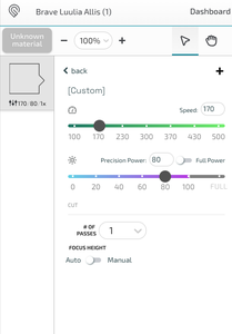

Step 8: Place the Material and Starting to Cut
Place whatever material you are using for your puzzle pieces. Select the power and speed. (I used cardboard, and put it on 80 power, 170 speed.) Then, move the outline of your puzzle pieces to wherever you would like to cut them out.
