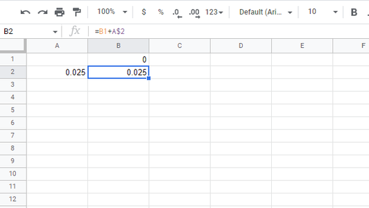

Put the starting value for the input variable in B1. Put the step for the input variable in A2. Put "=B1+A$1" into B2. Copy B2 down using the handle on the lower right corner of the box until you get the desired maximum value for the input variable. In this example I use 0 as the start, .025 as the step, and 2 as the max.

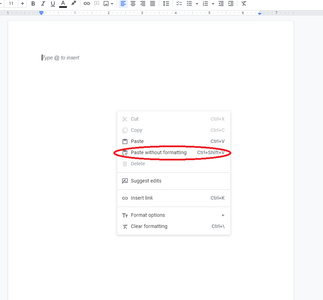

Right-click and click "paste without formatting" (or use ctrl+shift+v to do the same thing).

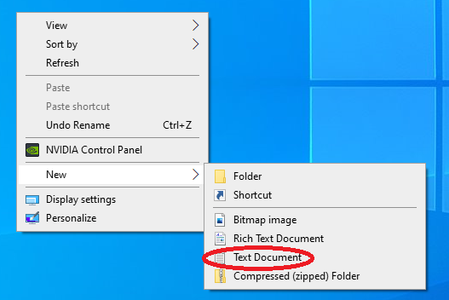

Create a new plain text document by right-clicking the desktop or a file explorer window, hovering over new, then clicking "Text Document." (The new doc should be a .txt file)
