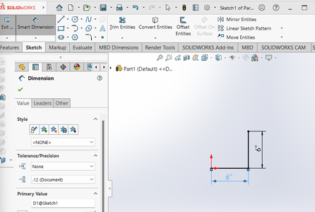

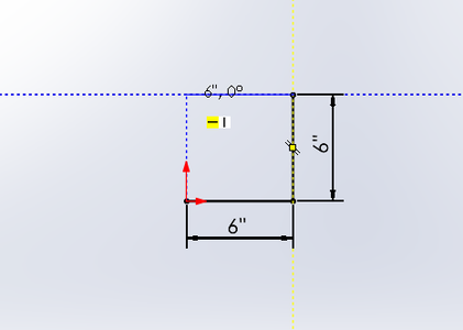

  1. Starting at the origin point, students should select the line tool from the Sketch tab and draw a horizontal line.
  2. From one of the endpoints of that line, draw a vertical line using the line tool.
  3. Once the two lines are drawn, students should select the “Smart Dimension” tool, located to the right of the Sketch command button.
  4. Once the tool is enabled, students should select the horizontal line and a length dimension will appear.
  5. When the Modify dialog box appears, students can change the dimension value to 6” and press enter.
  6. Repeat steps 3-5 for the Vertical line.
  7. Once the two lines are set to 6”, students can draw the other two lines following the smart guides that appear to form a square.
  8. Make sure the figure is Fully Defined by checking that each line is black before continuing.

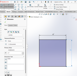

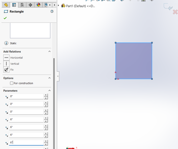

  1. Using the corner rectangle tool from the Sketch tab (default rectangle sketch setting), students should start at the origin point and drag outwards to create a rectangle.
  2. Once the rectangle has been sketched, the Rectangle dialog box should appear on the left side of the screen. Under the Parameters section, students should change each of the previously defined parameters to 6”.
  3. If the Rectangle is not fully defined, students can use the Smart Dimension tool to dimension the undefined sides.

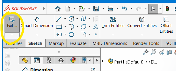

  1. Once your 6” x 6” square is sketched, select “Exit Sketch” from the Sketch tab.

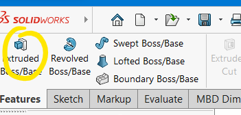

  2. After exiting the Sketch command, students should switch to the “Features” tab.
  3. In the Features tab, students should select the “Extrude Boss/Base” tool.

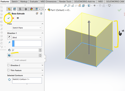

  4. Students should select one of the sides of their square to open the Boss-Extrude dialog box.
  5. The settings in the Boss-Extrude dialog box should be set to:
  6. From: Sketch Plane
  7. Direction 1: Blind
  8. D1: 6 inches
  9. After the settings are set as mentioned above, students should hit the checkmark in the top left corner of the dialog box to create their cube.

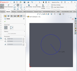

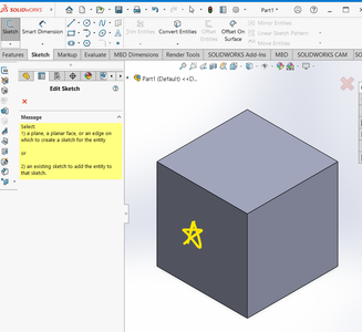

  1. After the square has been extruded into a cube, students should move back to the Sketch tab and select the “Sketch” tool.
  2. Students should select the front-facing side of the cube as the Sketch plane.
  3. Select the Circle Tool from the Sketch tab.
  4. Starting at the center point of the square, students should drag outward from the midpoint to create a circle with a radius of 2. (Ensure the radius is equal to 2 by entering 2 in the radius parameter under the parameters section of the Circle dialog box that appears once the circle is drawn.)
  5. Use the Smart Dimension tool to define the radius/diameter of the circle, ensuring the student’s circle is fully defined.
  6. If the student’s sketch is still not fully defined after dimensioning, right click on your sketch and choose “Fully Define Sketch” from the pop-up menu. When the Fully Define Dialog box appears, students should make sure both boxes are checked and hit calculate and the check mark to fully define the sketch.

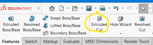

  7. After the circle sketch is fully defined, students should switch back to the Features tab and select the “Extrude Cut” tool.
  8. When the Cut-Extrude dialog box opens, students should change the settings as needed to say (also pictured below):
  9. From: Sketch Plane
  10. Direction 1: Open the Drop-down menu and select “Through All”

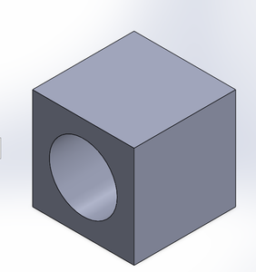

  11. After ensuring the dimensions are set correctly, students can hit the Check Mark, and the circle should be cut through the cube.
