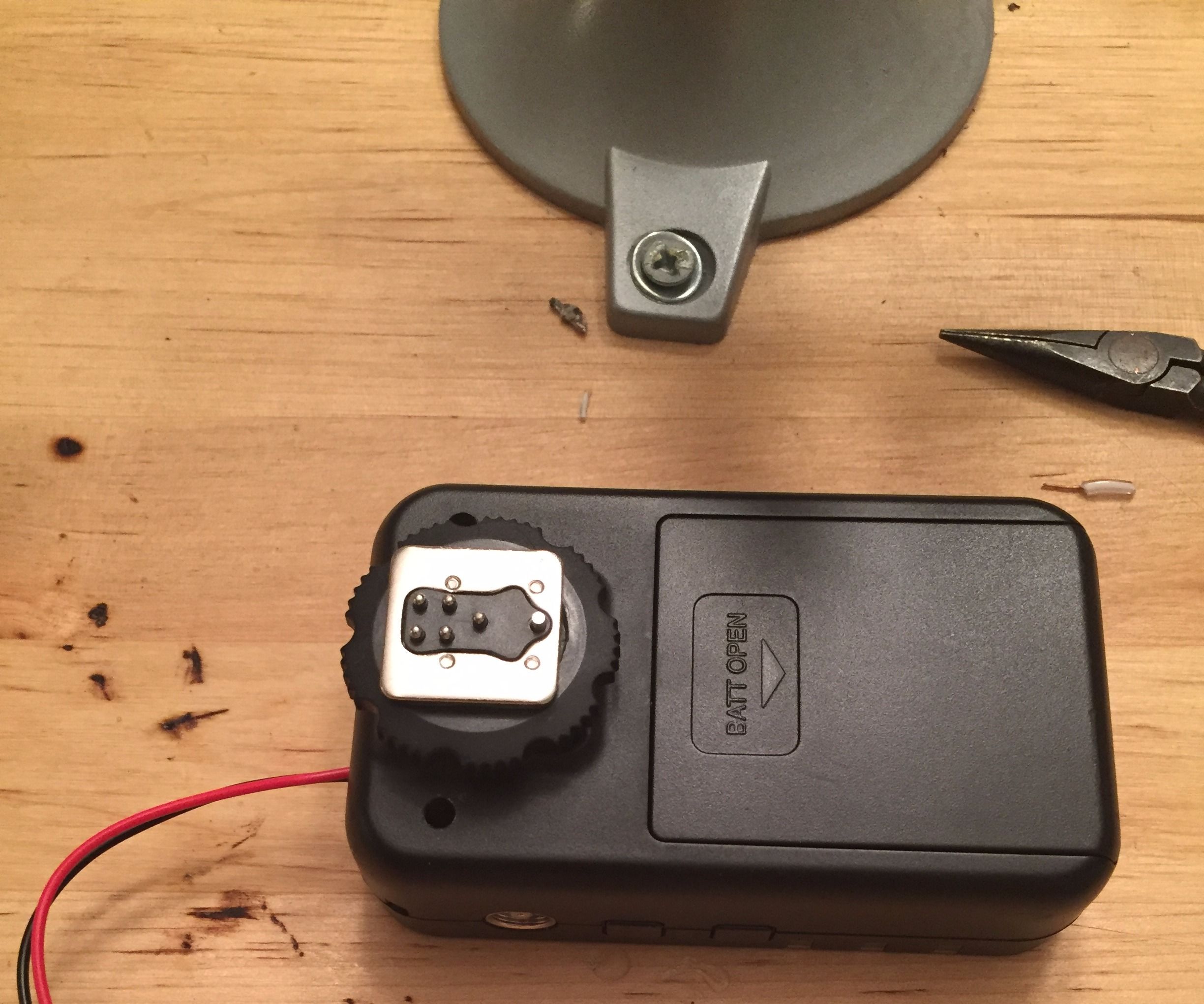

Step 4: Cold Shoe Adapter
At a minimum, most likely, you need to attach your flash to the Tree Mount. A cold shoe mount attaches to the 1/4-20 thread of the Tree Mount and allows us to attach a flash. These are the cold shoe adapters that I use: Cold Shoe Flash Adapters.
The disadvantage to this solution is you lack flexibility in directing the flash.
