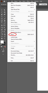

Step 2: Place Sticker
Place sticker image file and resize as necessary

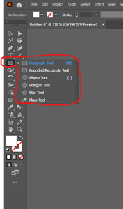

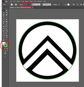

Step 3: Shape Tool
Use the shape tool to create cut lines for your sticker.
Tip: Use simple shapes like rectangle, rounded rectangle or ellipse to get the best cut results. Right click on the shape tool to change which shape it draws.
Step 4: Change Appearance
Set appearance properties of your shape to make it easier to visualize your sticker cut.
Tip: Make sure the Stroke property is in front by clicking it once. It should look like the example image.
Tip #2: The color you choose does not matter, but it is recommended to choose a color that is contrasting from your imported image

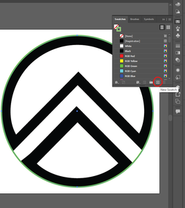

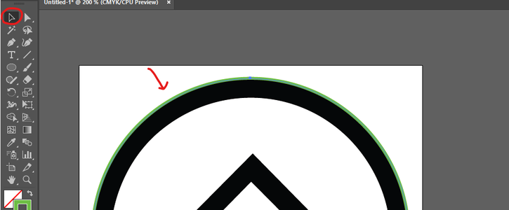

Step 5: Black Arrow
Select your shape with the black arrow open the Swatches Tab
Tip: If you do not see the Swatches tab, reset your workspace by clicking Window>Workspace>Essentials Classic or Reset Essentials Classic
Step 6: Swatch
Select the Add Swatch Symbol (plus sign)

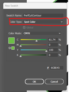

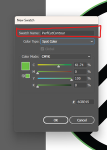

Step 7: Name Swatch
In the pop-up, name the Swatch “PerfCutContour” or “CutContour”
Tip: Spell the name exactly as shown above, otherwise printer will not recognize the cut
Tip #2: If you would not like to cut all the way through the sticker paper, and only the vinyl top layer, name the Swatch “CutContour”
Step 8: Spot Color
Select “Spot Color” in the dropdown menu

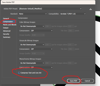

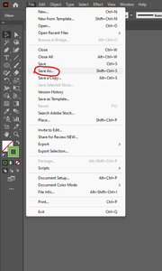

Step 9: Save As
Save as PDF
(File -> Save As -> PDF)
Tip: Uncheck all the boxes in General and Compression sections.

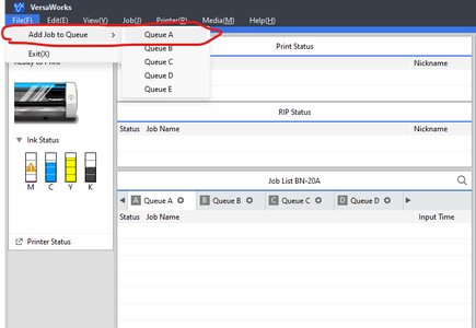

Step 11: Into Queue
Add your PDF File into Queue
Tip: It doesn't matter which queue you choose

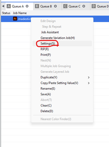

Right click your imported Job and go to “Settings”

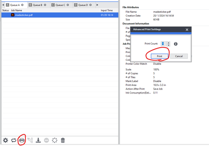

Step 17: Print
The job is ready to be printed. Click the print icon and leave it at 1 copy.
