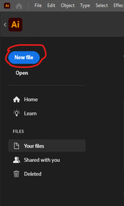

Step 1: New File
In Adobe Illustrator, create a new file.

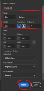

Step 3: Canvas Size
Set your canvas width and height to be slightly larger than your desired artwork. Then, press Create.

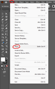

Step 4: Place Image
Click File>Place to insert your image onto the canvas. Select your image file and then click anywhere to place the image.

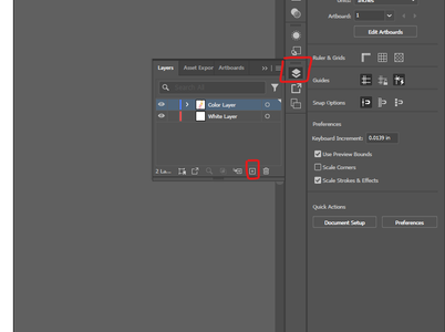

Step 6: White Layer
Steps 6-20 deal with creating a ‘white layer’ for the DTF printer to print. If your artwork requires white in it, go ahead and create a new layer. Double click on the layer names to rename them. The layer with your image on it should be called something like ‘Color Layer’. Drag the new layer underneath the color layer and rename that new layer to ‘White Layer’.

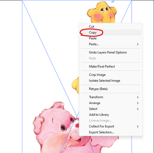

Step 7: Copy
Right click on your artwork and Copy it.

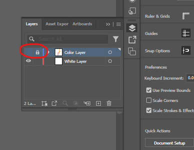

In the layers panel, disable the Visibility of the color layer by clicking the eyeball, and in the empty box next to it, enable the Lock on that color layer. This just prevents you from accidentally moving it throughout the process.

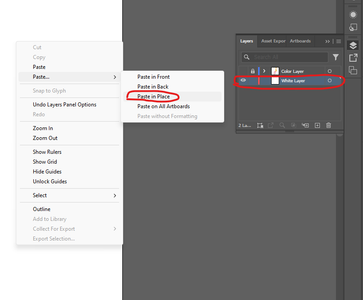

Step 9: Paste
Select your ‘White Layer’. Then, right click onto the canvas and use Paste>Paste in Place.

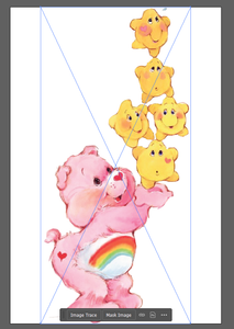

Step 10: Trace
With your copied artwork selected, use the Image Trace drop down arrow to convert your image into a solid, vector shape. Depending on how many colors are present in your artwork, use either 3, 6 or 16 color image traces to get the best result.

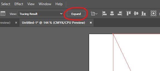

Step 11: Expand
Now, Expand the traced image. This will simply finalize the vector shape.

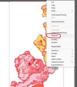

Step 12: Ungroup
Right click on your canvas and Ungroup your traced artwork.
Tip: Sometimes you must ungroup multiple times, if your artwork somehow was split into subgroups.

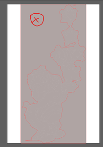

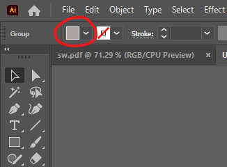

Set the appearance for your white layer. You can pick any Fill color that is visible on your white canvas. Ensure the Stroke is disabled as seen here.
Step 14: Delete Unwanted
Deselect your traced artwork by clicking somewhere blank on the canvas or screen area. Then you can select the border shape the trace had created and remove it if desired. This will leave only the solid shape of your artwork to be printed as a white layer down the line in this process.

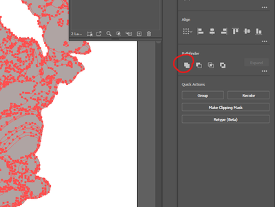

Step 15: Union
A Lot of the time, there will be tiny gaps between the shapes that were generated during the tracing process. You can clean this white layer shape up by simply using the Pathfinder tool ‘Union’ to unite all the mini shapes into one single shape.
Step 16: Clarity

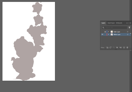

Just to clarify, your shape representing the white layer of print, should be on its own layer as shown here, underneath the color layer. You can turn the visibility of your color layer on and off to ensure the position and size of the white layer match your color layer.

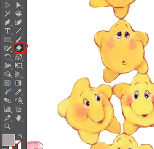

Step 17: Erase
You may have sections of your white layer that should not be present, usually in isolated areas within your artwork. Simply use the Eraser tool to remove those sections of your white layer. You can easily change the size of the Eraser tool with the square bracket hotkeys  ‘ [ ‘    ‘ ] ’

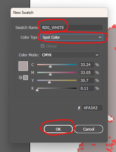

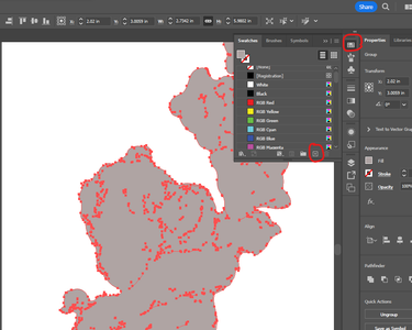

Step 18: New Swatch
In this next step we will be creating a Swatch for the white layer shape. With your shape selected, open the Swatches panel and click the + icon to create a new swatch.
Step 19: RDG_WHITE
Type RDG_WHITE into the swatch name field and change the color type to Spot Color. Then, press Ok.
Step 20: Hide White Layer
Lastly, before we save our file, turn the visibility on for your color layer. This will hide your white layer, but it is still there and will be read by the DTF printer software as a white layer to be printed.

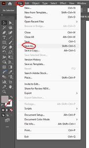

Step 21: Save As
Click File>Save As to save your file.

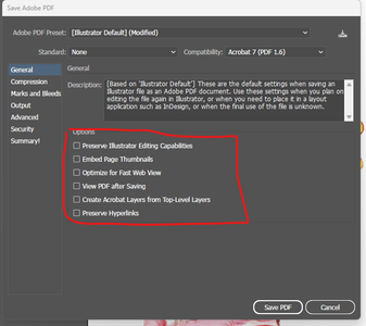

Step 22: PDF
Name your file and change the file type to PDF and press Save.

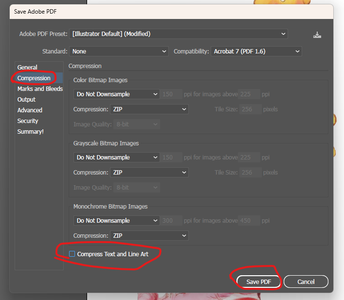

Step 23: Uncheck All
Uncheck all the boxes in the General and Compression tabs before pressing Save PDF.

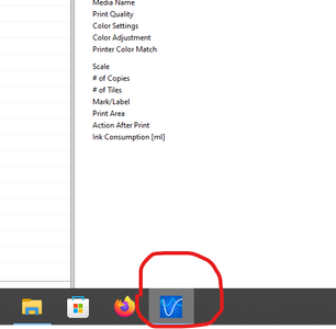

Step 27: Versa Works
Open VersaWorks

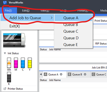

Step 28: Add to Queue
 Add your PDF File into Queue

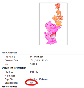

Step 29: Check White Layer
For prints that have a white layer, look at the image properties and observe “Special Characters”

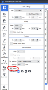

Step 30: Cut Controls

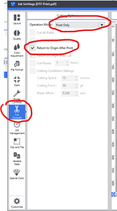

Double click on the job in the queue to open settings. First check the box to Mirror the artwork. You can add as many copies as desired here as well. Then, click on ‘Cut Controls’ and set the job to Print Only and Return to Origin after Print. This setting allows for you to print the color layer and white layer in the same position. Then click OK.

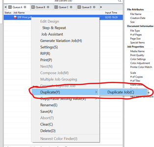

Steps 6-10 are only for printing a white layer. Simply right click on the job in the queue and use the Duplicate>Duplicate Job function. The name of this copy can be changed to white layer if desired.

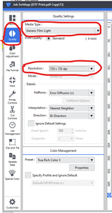

Step 32: Media Type
For white layers, you need to double click on the duplicated job and click Quality to set the Media Type and Resolution. The Media Type is either light or dark depending on the fabric you are going to be using. The Resolution will be set to 720x720 to activate the white layer printing.

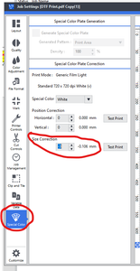

Step 33: Size Correction
Now click on Special Color. We will set Size Correction to -3 in order to offset the white layer inwards so that it doesn't bleed or show up around the brim of our design. Press Ok

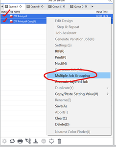

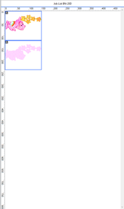

Step 34: Group Up
Now we must group the two jobs so that they run in sequence. Select both jobs by clicking them and holding down Shift. Right click on either of them and use the Multiple Job Grouping function. The order of the jobs should be color layer and then white layer.

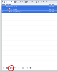

Step 35: Sequencing
Your job preview should look like this with the color layer and white layer showing up in sequence.

Step 37: Print
The job is ready to be printed. Click the print icon and leave it at 1 copy.

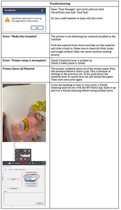

Step 43: Trouble Shooting
