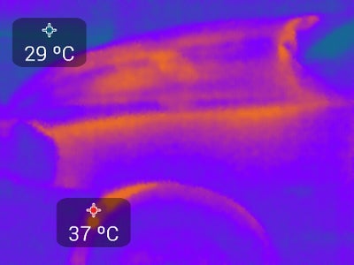

Ah! A thermal image of my morning cup of tea. That image shows heat emitted doesn't it? I took that image using my Seek Thermal XR camera. This an entry level microbolometer, or in lay person's terms: a thermal imager.

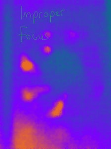

Most thermal imagers come with a focus ring to allow manual focusing of the image, or the higher end units have auto focus. Getting a good focus and paying attention to the distance to spot ratio (basically dont stray far from your measured target else accurancy drops) are important.
Being perpendicular to the traget helps alot to get a cleaner image and more accurate temperature readings.
Take for example the visual image of a UPS cooling fan. The first thermal image is blurry and not focused. The second image is focued and offers more detail for troubleshooting (eg. failing fan bearing). Here is an excellent example of the resolution difference between a standard visual camera and an entry level thermal imager. You need to appreciate the limitation of resolution and the ability to now "see" hot and cold spots. Higher end (and extremely expensive) thermal imagers will give better resolutions.

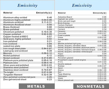

The perfect black body (this is the actual definition so please no jokes) has an emissivity of 1. An imager set to this emissivity value will give a fairly accurate reading on the target's surface temperature.

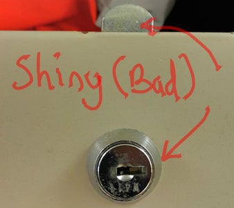

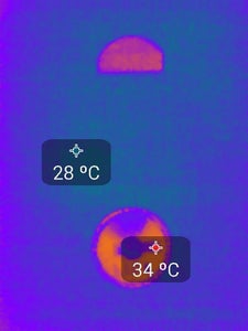

Real world objects have a range of emissivity values. The table attached has examples of these values. Basically shiny surfaces have low values and are difficult to read. Why? Infrared radiation, like visible spectrum, is reflected by shiny surfaces. Taking a thermal image of a shiny copper busbar will give a reflection of heat sources and even the thermographer taking the images! Standing in front of a mirror with your thermal imager will give you an image of yourself. Reflections are very bad for good imaging and also accuracy of the temperature readings. Blocking off external infrared sources will help in addition to standing at an angle from perpendicular.
Here is a good example I made right here in my office. The lock for my overhead bin is shiny. The thermal image says the key hole is 34C! This is a wrong temperature due to infrared radiation reflected from a nearby light. The thermal imager lied to me because I did not apply it properly. Dont let this happen to you!

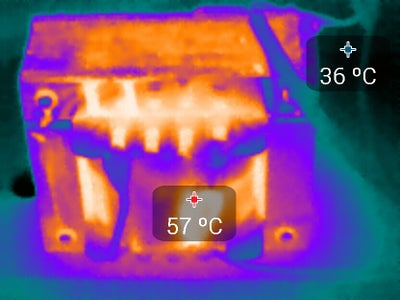

Motor bearing running hot due to failure, belt not properly tensioned on a pulley, heat being lost due to degenerating insulation on a furnace, imbalance of current on a three phase supply in a panelboard, winding failure in a dry type transformer, water leak inside of a wall are a few examples of how powerful even a basic thermal imager is when it comes to picking up problems.

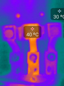

Take for example the last image. This is a three phase circuit breaker. The middle phase clearly shows higher heat than the other two. Use of a clamp ammeter confirmed severe loading on that phase.
Remember that thermography is the fastest means to find problems but you must use follow up (different) techniques to get to the real source of the problem(s). For example a bearing running abnormally hot, use vibration analysis to give you more information. Components in the system that pulley is part of will have a part to play in its abnormal heating!

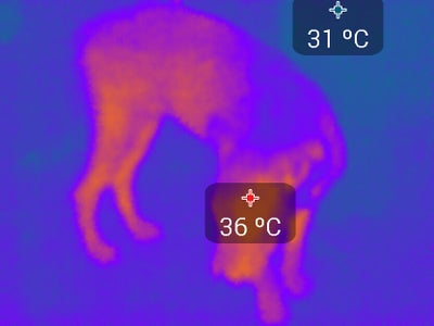

Here I had some fun and took a thermal of one of my doggies. LOL.
