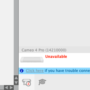

Step 7: Connect Silhouette by Selecting One Method on the Bottom Right Corner Printer Icon
