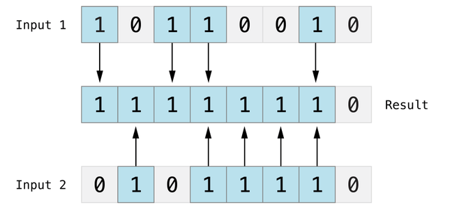

Step 2: BitWise OR (|)
Bitwise OR ( | ): This is same as OR Operator in digital logic. If we operate OR 0 with any Number 'N' then result will be the Number i.e. N. itself and if we operate OR 1 with any No Number then result will be 1.
For Eg. if the number is N, then N | 1 = 1 and N | 0 = N with value – 1 | 8 = 9 and 0 | 8 = 8.
Usage in MicroControllers
If you are using PORTA and want to Set pin 17 without changing rest of bits than by using OR Operator:
PORTA |= (1<<17) you can change that bit.
