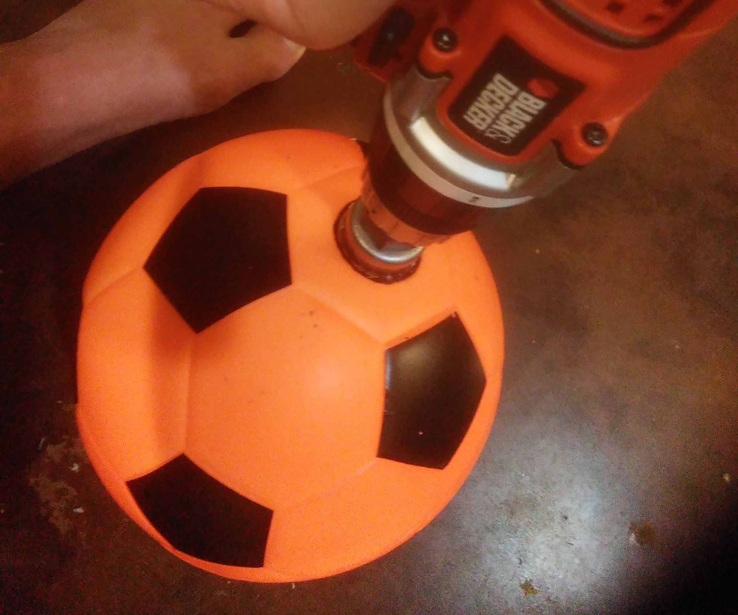

Part of the solution to the first challenge was to use the EV01 sports basketball. It held a small controller that was designed to help a player to improve shooting baskets. I don't know how well it worked or how successful the company is but it provided a basketball with a well designed container for me to add a sound device. It had a hard rubber plug that alowed it to bounce well and a sealed container that could hold a small sound device.

I had to sand the edges of the board down a bit to make it fit into the EVO1 cavity. The speaker (See references section) fit together with the PCB by mounting the switch flush with the edge and gluing across the edge of the switch and the edge of the board.The battery was a small rechargeable 120mAh Li-Po that I glued to the PCB (see references for details). It can last about 4 hours on a charge.
