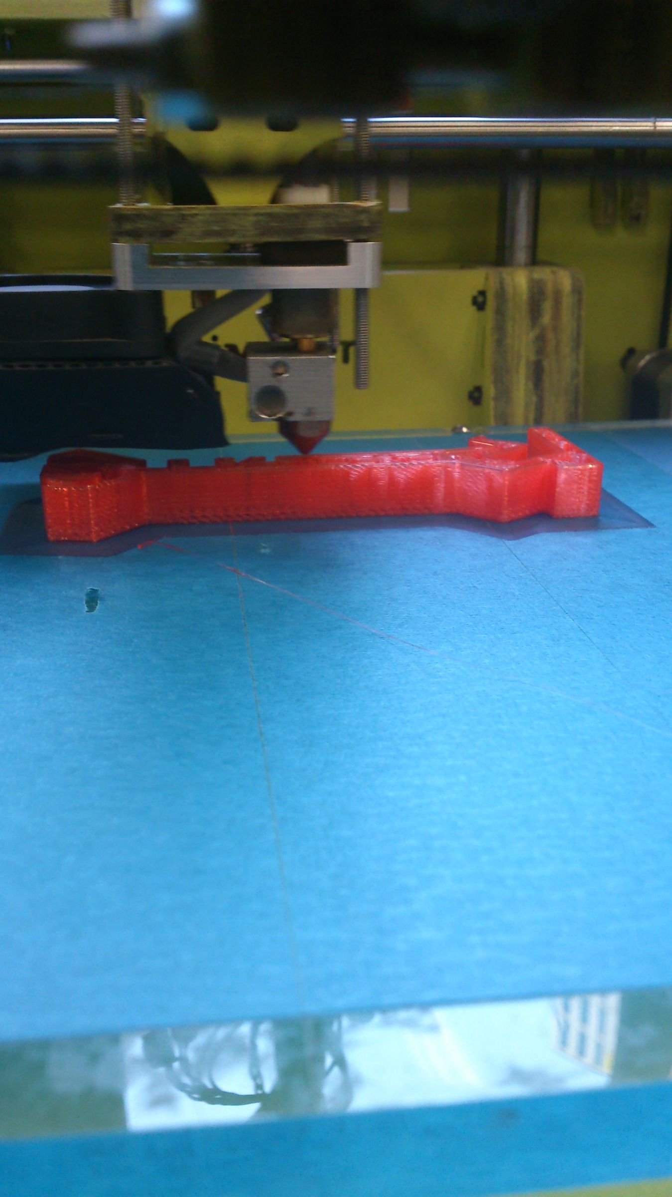

Step 4: 3d Printing and Laser Cutting
In this step you are going too 3d print the basketball ring and the matching hinge. You are also going too lasercut the perspex plate to accomplish the right form. for the 3d printer you need to download the files in the first stap (Basketball ring.stl and Basketballring hinge.stl). In the first picture of this step you see how you need too place the hinge too 3d print it on the right way. In the second picture you see how you need too place the basketball ring for the best print. When you'r finished 3d printing the hinge and ring you are ready to lasercut the backboard. Download the file for the lasercutter (BoardbasketballDXF.dxf) in step two and cut it out.
