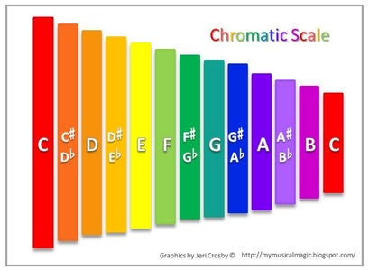

Step 6: Paint Tubes
Boomwhackers are color-coded according to their pitch. C is red and they proceed through the color wheel as the notes ascend through the chromatic music scale, as shown above. I painted the tubes according to the Boomwhacker color chart. After painting each coat outdoors, I stood them up on posts to dry. Two coats of paint were enough.
