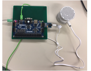

Materials (pictured above)

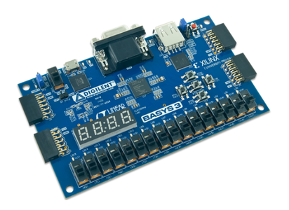

  1. Basys 3 Board (bottom left)
  2. Pmod AMP2: Audio Amplifier (bottom right), which can be found and purchased at http://store.digilentinc.com/pmod-amp2-audio-ampl...
  3. Speaker with an auxiliary cord
WARNING: Cheaper headphones/speakers with lower power rating might blow out. Be careful with what you choose to output the audio.

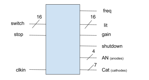

The top block box diagram above shows the inputs and outputs. The synthesizer takes in three inputs (switch, stop, clkin) and has six outputs (freq, lit, gain, shutdown, an, cat). “Switch” is a 16-bit bus that determines which frequency is used (i.e. what note/sound is played). “Stop” is a button that when pressed down, stops the sound from playing. “ClkIn” is the system clock from the board, which runs at 100 megahertz.

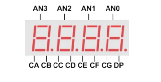

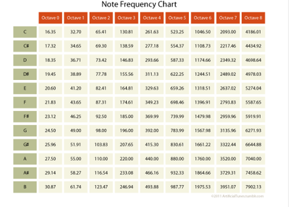

The sound output is “freq”, which toggles between high and low an x amount of times per second, calculated by dividing 100 MHz (from the system clock) by the note frequencies we chose from the "Note Frequency Chart" above, and dividing that by two (See sample toggle count calculation above). “Lit” displays a lit LED that corresponds with which switch is on. “Gain” when set high is 12 dB gain and when set low is 6 dB gain. Shutdown will kill pretty much all current allowed to the speaker if set to high. Finally, the anodes and cathodes are used on the 7-segment display to show which note is playing. In order for one of the segments to light up, both the anode and the cathode corresponding to the segment must be set to a “0”. The anodes and cathodes are shown above (bottom left)..

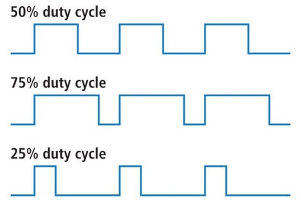

  • Use the extra buttons for extra modifications to the output signal.
    • One example of this would be changing the duty cycle of the signal.
