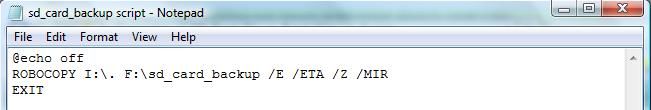

Here is the script for my system, you'll have to change yours so that you can copy what to where.
So type this out on Notepad!
@echo off
ROBOCOPY I:\. F:\sd_card_backup /E /ETA /Z /MIR
EXIT
I:/. (that's my target drive, the . is to specify "copy the whole thing")
F:/sd_card_backup (that's my destination drive, the "sd_card_backup" is the name of the folder I want to save it all in. If this older doesn't exist then one will be created. Oh, and my drive value is "F:/" cause I have an external one. Yours will probably be "C:/")
/E (tells the system to copy all the folders, even if there empty. This way you can have a complete replication of the folder/drive you copied.)
/ETA (will give you an Estimated Time of Arrival, see what they did there?)
/Z (you don't need to worry about this, it's just the type of copying that works best for small copies)
/MIR (again, this assures you have a mirror of what you copied, to make sure you've got absolutely everything)

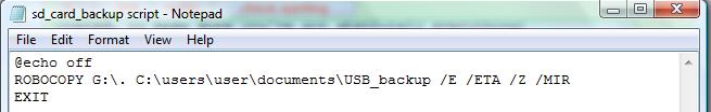

Your text may look like this if you were backing up your USB drive for example:
@echo off
ROBOCOPY G:\. C:\users\user\documents\USB_backup /E /ETA /Z /MIR
EXIT
This would copy your entire G drive (hopefully your USB) to your documents, creating and placing it in a folder called "USB_backup".

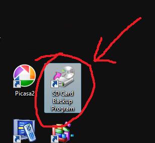

Step 3: And Hey Presto!
So that's basically it. The rest is really easy.
You just click on the file, and depending on the amount of stuff you copy, it might just flash up for a second and go.
If your really lazy then you can download the script for mine below and change it as you wish:
