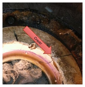

Step 5: Toilet Trouble
When I pulled up the wood flooring around the toilet flange I found some wetness and discoloration. The staples came out very easy in this area. I put a space heater in the area directed at the floor to dry out whatever moisture I could. I left the space heater on the area for about 12 hours just to increase the possibility that it dried out completely. I found out later that during initial assembly of the house, the builder installs a flange that has a pressure proof cap. Then they will pressurize the whole sewer system to verify that there are no leaks before they finish the walls. Before installing the toilets, they will break out the pressure cap with a hammer or other instrument. It appears that whoever did this one wasn’t a very good shot. They nicked the side of the flange and broke it.
This toilet has been slowly leaking for 13 − 14 years. If it had been any worse it probably would have been caught in the first few years by wetness coming through the sheet rock below. After a couple days delay, I finally found a plumber that would repair the flange for a reasonable price. The repair took the plumber about 1 1/4 hours to complete and he did a great job.
I’m comfortable doing flooring and toilets, but I’m not as comfortable working on water systems. Go figure.

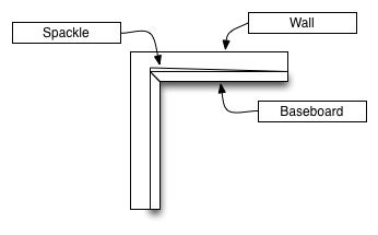

Step 6: Anatomy of a Baseboard
The baseboard is a decorative element located at the base of a wall. It also serves several practical purposes. First, the baseboard covers up the edge of the sheetrock which can have some imperfections or mis-cuts. Second, it allows a painter to paint the sheetrock close to the floor without having to do the fine edging work needed at the seam between the sheetrock and the floor. The paint edge will be defined by the baseboard, which is attached over it during final finishing. Finally, the baseboard also covers up the edge of the flooring, in this case linoleum flooring. The gap between the flooring and the stud wall adds up to approximately 3/4” to 1”. This space will give the flooring some play on every wall where there is a baseboard. The play can significantly improve the chances that minor mis-cuts in the linoleum will be covered up.
The important thing to observe when laying out the measurements for a floor, are which edges do have a baseboard, and which edges to not have a baseboard. If possible, cut edges that have a baseboard and not edges that do not have a baseboard.
Where there is a seam between a shower or tub, the linoleum will butt up to the vertical and it will be sealed bathroom grade caulking.

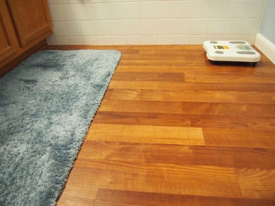

After assessing the situation, I decided on a plan of attack. I rolled the smaller section of flooring up onto the larger section. In this smaller section, I poured out approximately 2 cups of adhesive onto the floor and used the applicator to spread it out evenly. Working from the corner toward the remainder of the room. Don’t over-do it. Excess adhesive will cause a bubble. And once a bubble sets up, you won’t be able to get rid of it. If you find that you have too much adhesive, scrape it back into the container.
Once I had covered the smaller section with adhesive, I rolled the linoleum out over it. Next, I lifted up one side of the larger section, and inserted myself between the linoleum and the wood flooring. I worked my way under the linoleum from the opposite end back to toward the exit. I worked my way toward the exit and emerged from under the linoleum. Then I came back in on top of the linoleum now and spread it out on the adhesive. If I had assistance, I would have had them prop the linoleum up on a broom handle while I worked below.
Finally, I walked over the whole floor several times, pushing the linoleum down into the adhesive. I inspected the linoleum with a bright light to find any bubbles. Removing them by using a small 2”x4” board covered in cloth to work the bubbles to the nearest seam.

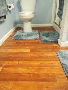

Next came the toilet re-install on the new toilet flange. I centered the new toilet wax seal on the flange, slipped the new toilet bolts into the flange, and carefully placed the toilet into position on the wax seal while lining up the toilet bolts with the bolt holes in the toilet. After that’s all lined up, then Sit down on the toilet to squish it into the wax seal. Gentle direct pressure and resist the temptation to rock back and forth — just let it ease down into the seal. Once it’s stopped moving, then bolt it down. Tight enough, but not too tight. Too tight will cause the toilet will crack. I reassembled the tank and re-attached it to the water line. Here is a link to a good article specifically on toilet assembly
Finally, I caulked the toilet, the seam between the tub and linoleum as well as the seam between the shower and the linoleum. I cut the caulking tube for 1/4” bead and laid down a a bead at the seam between the toilet and the linoleum. Then I used a wet finger to press into the bead and push it into the seam. Ideally the seam should look something like this.
Over time, I’ve found that the less I think about caulking, the better seam I can create. So I generally do it very quickly and don’t even consider going back to re-do an edge. Whenever I do that it turns out to be more of a mess.
Well, that’s about all to it. The job took about 24 − 32 hours total. It depends on how I count the time it took to get the toilet flange fixed. Overall I’m very happy with the outcome. I hope you’ve enjoyed reading my description of the work.
