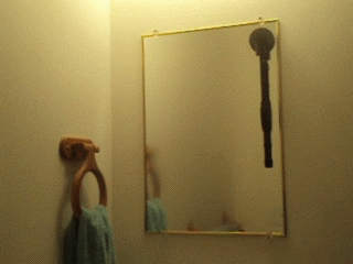

Measure and decide what length of blade you'd like for your mirror. This will largely depend on the size of your mirror.
Step 3: Disassemble Wiper Arm
Disassemble the whole wiper arm. You may need to get creative with this step to get everything apart.
Step 4: Straighten Wiper Arm
Using a vice or hammer and anvil, straighten the windshield wiper arm.
Step 5: Size Windshield Wiper
Because of the size of my mirror I needed a really small windshield wiper. Not being able to find an 11 inch windshield wiper, I purchased the shortest one available and cut it to the necessary size.
- Remove plastic end caps
- Mark center
- Mark where to cut
- Cut wiper material
- Cut support material
- Reattach plastic end caps
Step 6: Clean Up Wiper Bracket
Clean up and sand the wiper bracket.
Step 7: Drill Hole
Drill a hole the size of the suction cup post. If using the suggested suction cup, drill hole to 5/8".
Step 8: Remove Pin and Test Fit
Using a pair of Vice Grips or pliers remove the pin in the suction cup. Make sure that the arm fits perfectly with no play. If for whatever reason there is play you could possibly use painters or masking tape to fill in the gap.
Step 9: Cut and Shape Arm
Now that the center is the proper size, cut the bracket to length. Grind the face flat and shape to your liking. Cut a channel in the back to accommodate the wiper arm.
I used an end mill to cut the channel. If you don't have access to these tools, you can skip this step.
Step 10: Attach the Wiper Arm to the Bracket
Secure the arm and bracket together using a screw and roll pin. I understand that this design is extremely overkill, but I know that it will not come apart.
Step 11: Cut Down Suction Cup
Cut the stem of the suction cup down and secure the wiper assembly in place using nylon washers.
Step 12: Fill in Suction Cup
This suction cup didn't have a solid stem like I originally anticipated. Since it's hollow the center needed to be filled. This can be done with Bondo or simple wood filler like I used. Once dry, sand flat.
Step 13: Paint
Tape off the actual suction cup material to protect it from the paint. Paint it black to match the windshield wiper blade.
Step 14: Enjoy Clean Mirrors!
Install your new windshield wiper and enjoy clean mirrors!
