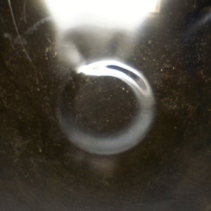

To make an 8,00 euro bowl into a sink, we need a hole that fits a standard drain.
If we just drill a hole, the water will never be fully drained because of the raised edge of the drain. So we need to make an indentation to lower the drain.
I pressed this dent in the bowl with a mold made out of a piece of hardwood:
  • Drill a hole in de hardwood with a hole saw. This hole should be the outer size of the drain.
  • Use a file to smooth out the edge of the hole.
  • Take the hole you drilled out and use a power sander to create a chamfer in the angle of the drain.

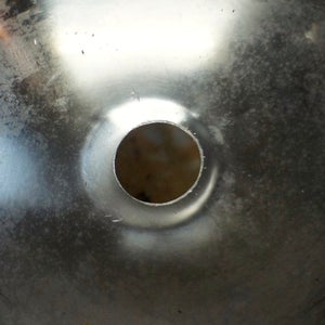

  • Put the bowl with both pieces of wood in a machineshop press.
  • Press until you have the dent you need. (2 - 3T must be enough pressure)
  • Use a hole saw in the size of the inside of the drain to cut a hole in te bowl. (use cutting fluid)
  • Clean of the sharp edges with a file.

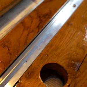

The aluminum doors will slide in aluminum F-profiles. But aluminum doesn't slide very well on aluminum, so I used a 4x4 mm brass rod inside the bottom F-profile to make de door slide better.
The sizes of the F-profile, you can see in the picture.

The F-profiles
The F-profiles must be cut to the width of the cabinet. I drilled some holes in the lips of the profile to screw it on the top and bottom of the cabinet. ***make sure not to drill holes in the middle 34 cm of the profile, where the middle door will come!***
Screw the bottom profile on the front edge of the bottom plank. The top profile will be put just behind the thicker part of the cabinet top, so the two will be exactly opposite one and other. The top profile will be totally out of sight.

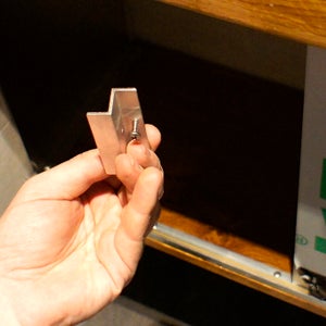

You can use silicone to glue the middle door in place on the inside against the slots for the other doors. I used some Z-profile to clamp them in place. I screwed the pieces of Z-profile with one screw each in place, so I can turn it sturdy against the middle door, to make sure it doesn't rattle.
Easily put the other two doors in the slots and remove the protective foil from the doors.
