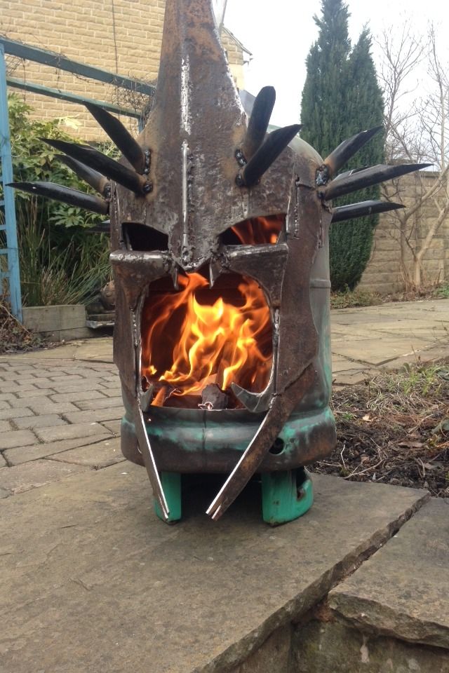

Step 1: Find Inspiration
Step 2: Cut It
Only ever use gas bottles from companies that have gone out of business otherwise you couldn't land yourself in trouble. Bottles remain the property of the company even if they're empty. Before cutting make sure it's empty, smash off the top with a big hammer and fill with water to displace any left over gas.
Step 3: Facial Features
I used some box section to create the nose, cheeks and eyebrows.
Step 4: Ears and Ears
More box section for the bat ears and some flat plate for the man ears.
Step 5: A Stern Face
I was unsure whether to go for a door on this burner but glad I did.
Step 6: Air Intake and Door Latch
Because there is only a small hole in the front of the burner I was worried that the fire wouldn't get enough oxygen. I decided to place an air vent on the side with batwing detailing.
Step 7: In the Raw
Step 8: Paint
All my burners are finished in UHT paint, this one got black and clear.
