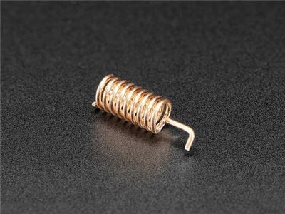

  12. 2 915 MHz quarter-wave antennas

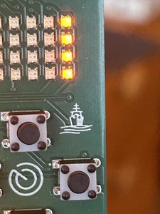

You’ll have two working radios that play Battleship. Of course, turn both radios on. Your ships will be randomly placed on the left screen in blue. Use the four direction buttons to move your cursor on the right screen. Press the fire button to attack. A miss lights up pink, a hit shows orange. When it’s the other player's turn, the WS2812B-2020 LED turns red.
Your own ships (left screen) show orange when hit and pink when missed. When a player loses all their ships, the game sends a winner transmission message. Any player can press fire to start a new game.
