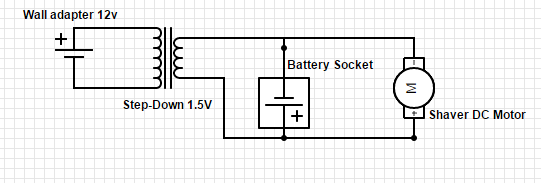

Ever wanted to stop using crazy amounts of AA batteries for small devices and wanted to plug it in the wall instead? Well then just use this Basic regulator LM2596.
No, I couldn't have used rechargeable batteries, because I don't want to bother recharging them : I already use some for other applications.
The LM2596 Module can regulate an input voltage of 4.5v to 40v into an output voltage of 1.5v to 37v.

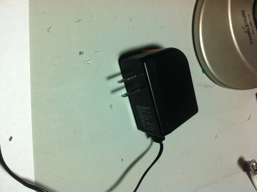

-12 volts, 1 or 2 amps output wall adapter

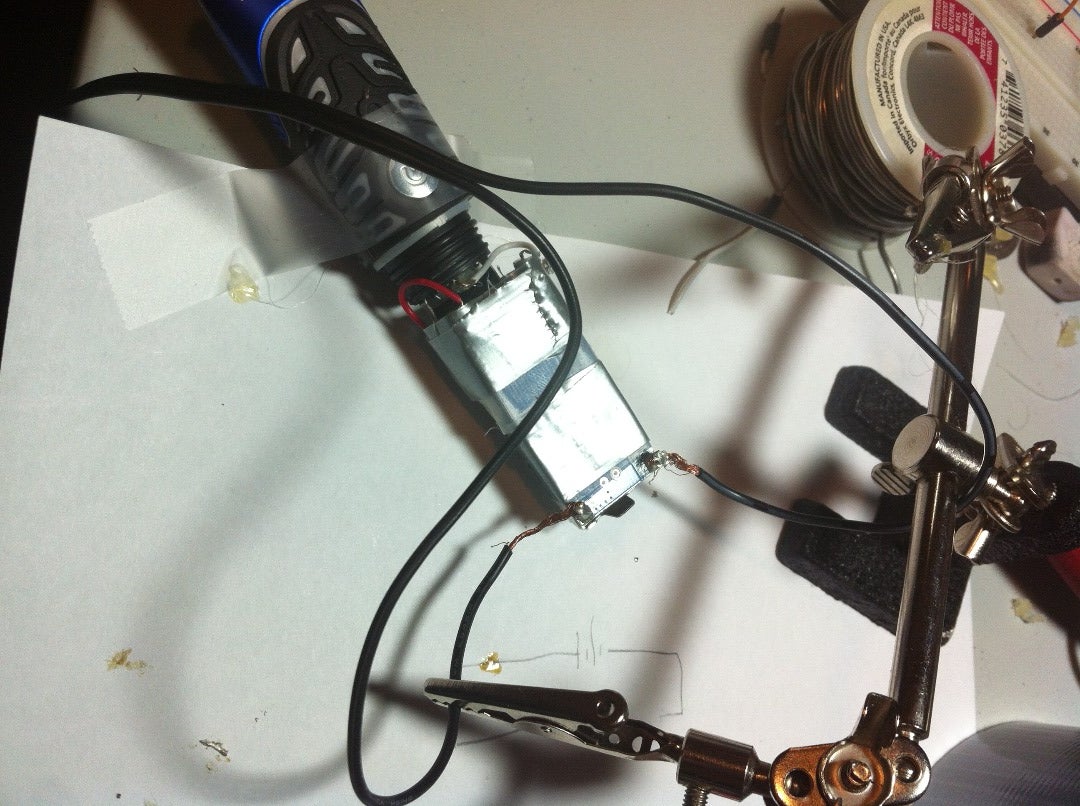

Step 2: Welding, Gluing, Taping

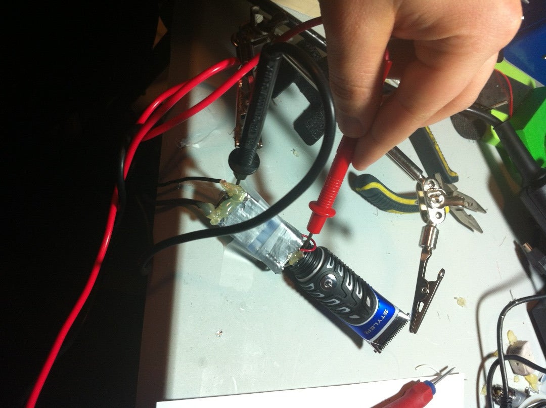

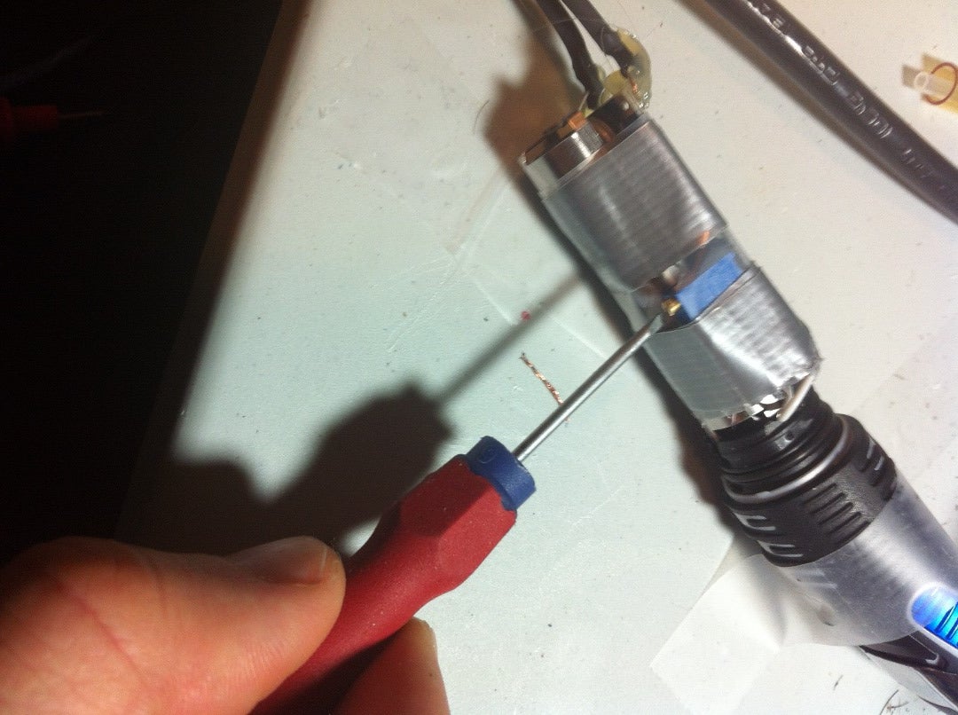

Step 3: Fix the Right Voltage
The right voltage is 1.5 Volts.
Initially it was at 12 V , before the voltage drop (like the adapter's output).

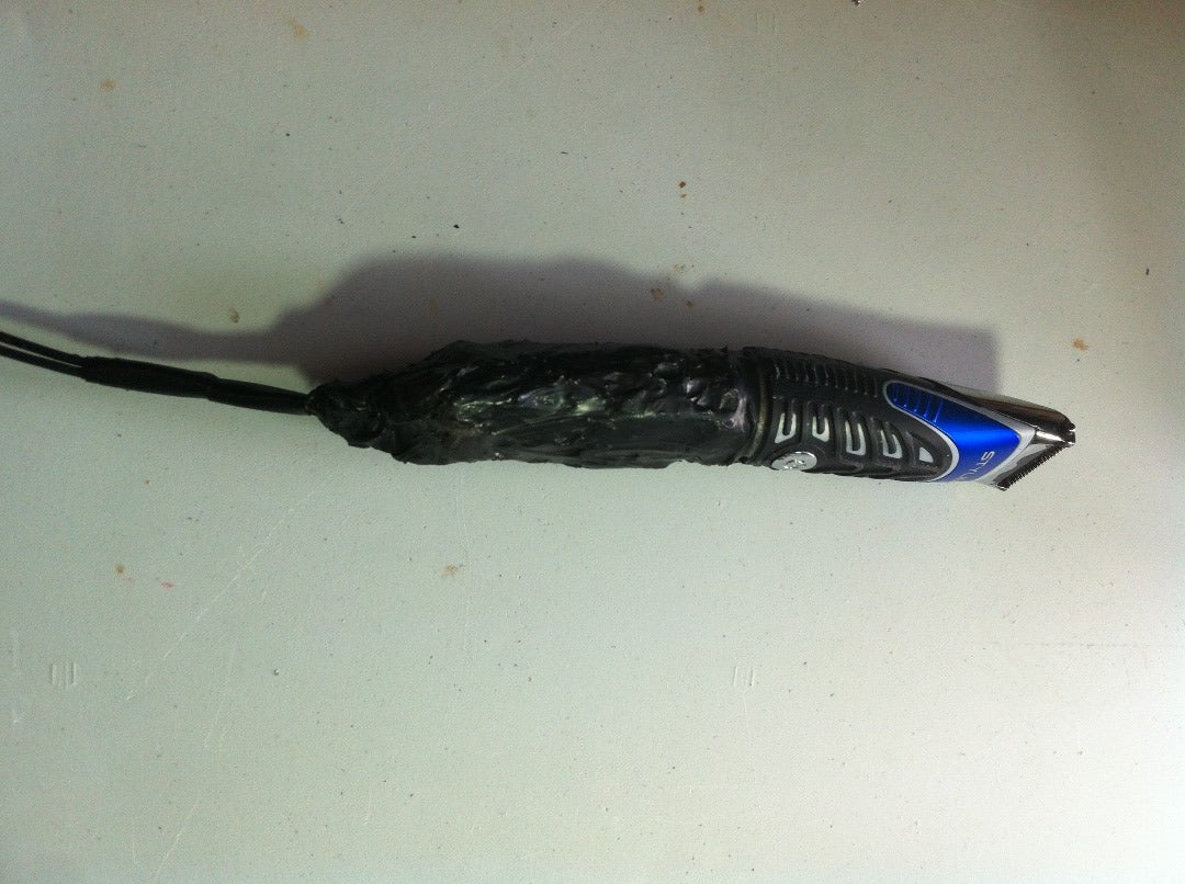

Step 4: Craft the New Handle
DO NOT USE THIS SEALANT. Its too long to dry and it doesn't give a good result.
Apply about 1 cm of sealant around the previously tape covered part.
Let dry for 7 days. Then give it the shape you want.
Step 5: Final Part : Paint It
