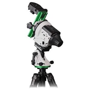

I pondered the problem of retaining the battery cover for a while. Mine comes off very easily because the metal body of the tracker is too thick for the barbed retaining tab to lock in. The solution usually proposed is to tape it in place but that seems like a rather crude solution so I wanted something neater.
Ideally I did not want to affect the warranty on the tracker but in the end decided that it would be necessary to drill two small holes in the battery cover. If the tracker did need to be returned under warranty then a spare battery cover can be bought and fitted. Spare battery covers are available from retailers such as First Light Optics at a low cost. If you did not want to modify the original cover then a spare could be purchased cheaply and that one modified and fitted.
A considered solution was to use magnets but they would have to be quite strong and since I use a magnetic compass to aid polar alignment this did not seem like a good idea!
The designed retainer can simply be slipped into a slot between the battery case and metal body of the tracker. This slot is just less than 1mm wide on my mount. The retainer is given strength by adding an arch over the metal body of the tracker and following the profile of the battery holder. No modification to the tracker is needed, the retainer just neatly slides into place.
Even though the retainer may be slightly loose, the battery cover will be retained as the cover has tabs that stop it lifting off. The screws prevent it sliding off.
