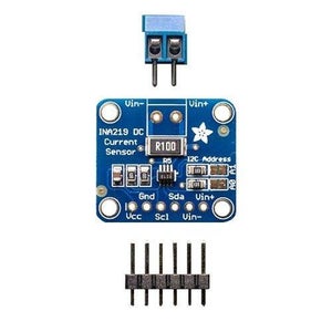

INA219 * 1

INA219 is I2C based sensor so Arduino pin A4 and A5 is used as I2C SCL and I2C SDA. we have to sacrifice two ADC pins for I2C communication there are alternative choices which can be made by using software based I2C but I can not assure its working behavior so I strongly recommend working with hardware I2C.

  • Read data available at INA219 current sensor.
  • calculate and store power consumption in Wh.
