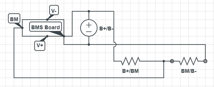

Step 4: Internal Resistance Measurement
  1. After battery is charged, it is needed to check the internal resistance of the pack. To do this, first, using a multimeter, measure the open circuit voltage between the positive and negative terminals of the battery output (record this value). Next, apply a 5 ohm resistor and measure/record voltage. Finally replace the 5ohm resistor with a 25ohm resistor and measure/record again.
  2. Using the values measured above, follow the calculations taken in the above image to solve for internal resistance of the pack.

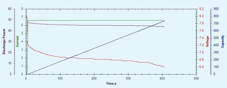

Step 5: Discharge Performance
  1. Attach battery pack to a BD-250 battery discharger
  2. Using the BD-250 Software, set battery type to Lithium Ion, 2 Cell, Desired final charge state, and discharge current to a value less than the battery is rated for (Can choose any value below this, but heating will increase if too much current is drawn)
  3. Click start on battery analysis software and wait until final state is reached.
  4. The images above are examples of what the discharge performance will look like. (NOTE: all batteries will vary in performance due to workmanship in the construction of the cells.) Power and performance over time will be visible from the provided information.
