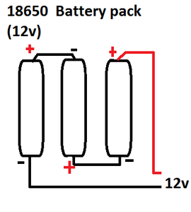

Step 3: Assembling the Battery Pack!
Now In This Step You Will Need Your 3 18650 Batteries!
I will Provide a schematic For The Battery Order But Still I will Guide You through it!
Now Each cell Contains A Charge of 4.2 When Fully Charged & 3.7 when Low On Charge!
So If We Solder The Batteries In Series The Voltage Will Multiply hence Giving Us -
4.2 x 3= 12.8v( When Charged)
3.7 x 3= 11.1v(When Low On Charge!)
Remember To Add a Female DC jack Connected Directly To The Battery Pack!
This Battery Pack Cannot Be charged by a 12v Charger, It Needs a special Kind Of Charger!
