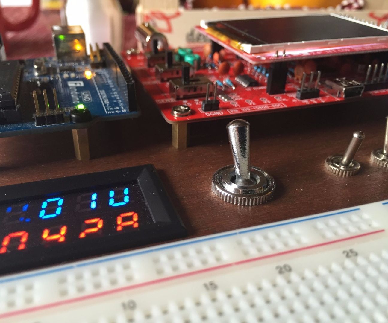

Step 6: First Run - Testing the Electronic
to be honest before I build the case I made a proof of concept prototype where I just throw together all the parts also useful to build the case and see what space I would need. In this picture you see my electronic load, this is the reason I come to instructables I see this instructable for the electronic load and just build it and when you are building a PSU there is nothing more useful then an electronic load.
Link to the great arduino controlled electronic load [link]
