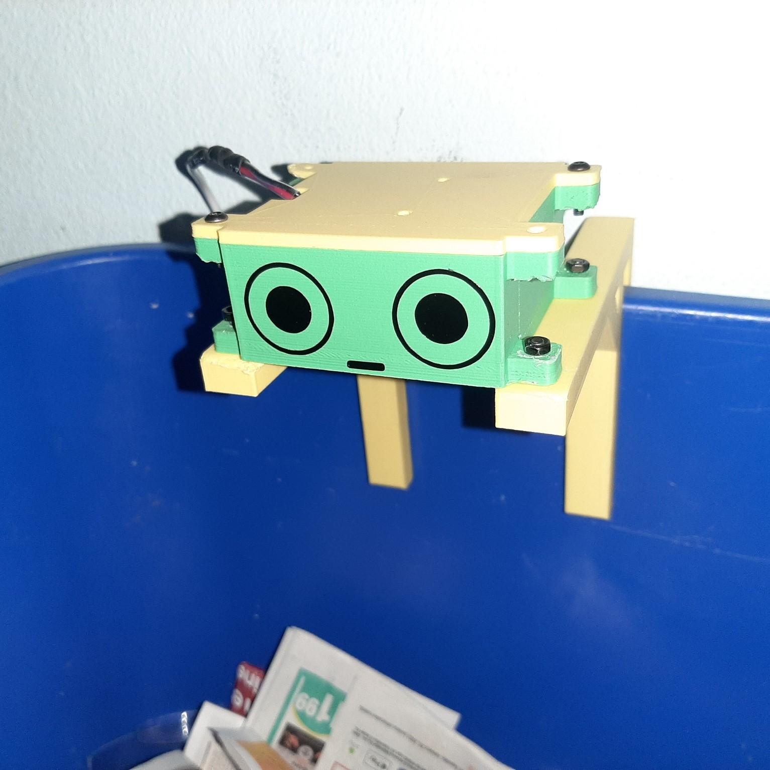

I wanted a way to keep track of how much waste I was generating just to be more environmentally conscious. So I created this project as an automated way to help keep track of waste accumulation through fullness measurements while also taking pictures of the objects thrown away.
To achieve this, I use the HC-SR04 ultrasonic sensor along with the ESP32-CAM. Doing this type of waste tracking is called a waste audit, which is a common practice used by universities to keep track of waste goals while also looking for opportunities increasing waste diversion rates.

Step 11: 3D Printing the Case 🔧
- Download the the STL files from https://github.com/zotbins/simple_waste_data_logger/tree/main/stl_files
- Set infill to 10% and use supports
- Print two of the sensor_mod_handle.stl
- Print one of the sensor_mod_top_assembly.stl
- Print one of the sensor_mod_bottom_assembly.stl
Currently, this design only fits on a bin with a 1cm width lip. You may have to modify the CAD file. I have included a Fusion360 file called sensor_mod_handle v9.f3d that you can modify to fit your needs. Another option is to design your own handles for your bin, I made the case pretty modular where you can create a custom attachment with M3 screws. In the future, I plan to create a more flexible design.

By this step, you should have uploaded the code to the ESP32-CAM with the microSD card inserted, have a prototyping board with the soldered circuit (HC-SR04, Female Headers, Battery Pack Holder) on it, and have a enclosure for all the components.
- Plug in ESP32-CAM into your prototyping board
- Put the assembled board into your 3D printed enclosure
- Attach the enclosure onto a waste bin
- Power your module by adding 3 AA batteries into the battery holder attached to the boost converter 5V and GND
- Congratulations! The code should start running and logging data!
- After a period of time, you can go ahead and unplug the SD card and look at what you've thrown a way and also see the fullness trend over time. It's definitely more meaningful to collect data over a long period of time than a short period.
