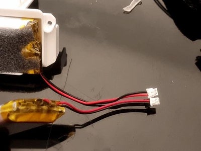

With everything outside, you’ll see the battery at the bottom. I had to measure it to be sure, but the text on it indicates the battery type: “103040”.

With the new battery at hand, it’s time to finish the repair. Avoid touching the PCB with metallic or conductive tools while the old or new batteries are plugged in.
Gently separate the old battery from the bottom of the white plastic piece.
Remove the hot glue securing the battery connector and firmly pull the battery connector out of the PCB.
In my case, the connectors were different, so I had to cut the wires from both batteries and solder the new battery onto the old connector.
Always respect the polarity, inverting positive and negative will almost certainly produce some blue magic smoke and kill the electronics, and remember that Nuliie does not provide spare parts.
Reconnect the new battery, the pump will light all the LEDs for a second and should be ready.
Press the power button to check if everything works, and also connect a charger to verify that the new battery charges properly.
I secured my new battery with tape and some neoprene on the back, but you can just reuse the sponge-like material from the old battery. Also put a drop of hotglue on the connector.
