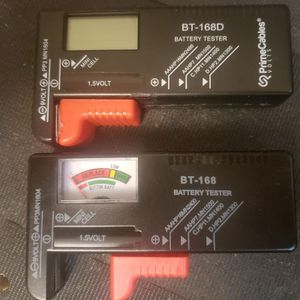

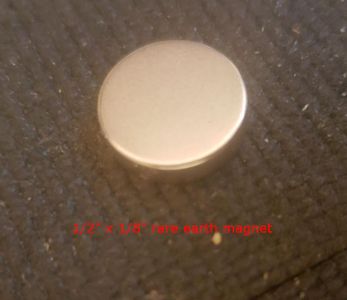

These battery testers are affordable and commonly used. They are handy to have but I find it difficult to test cell batteries because there is a dot at the bottom plate which cause the cell battery to slide around. After trying few fixes, I came up with this easy way.
All you need is a rare earth magnet of proper size. The one I used is 1/2" x 1/8" but you can try with different size that you have.
1/2" x 1/8" - $2.10 CAD

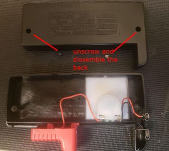

Step 1: Unscrew the Tester and Remove the Back Case
First unscrew and remove the back case.

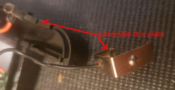

Step 2: Remove the Plate With the Small Dot
Now remove the plate at the bottom that has the problematic dot which prevents the cell battery from being put still.

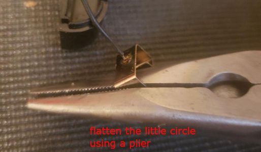

Step 3: Flatten the Dot With a Plier
Now flatten the dot with a plier and then put the plate back.

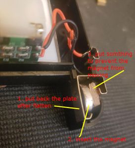

Step 4: Install the Magnet
Now just slide the magnet into the gap. You can use something to adjust the magnet location. (piece of small cardboard, foam paper, etc)

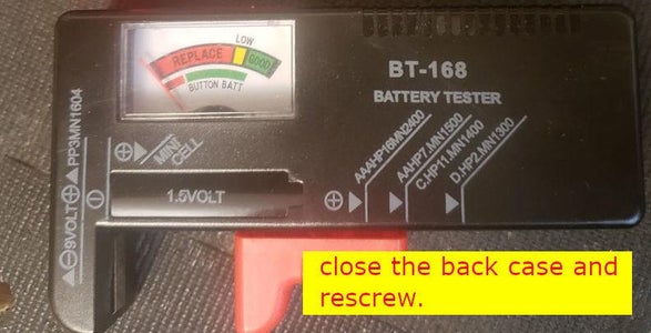

Step 5: Put the Case Back and Screw It.
Now it's time to put the case back and screw it. Just make sure the wire does not get in between the case or they might be damaged when you screw it.
