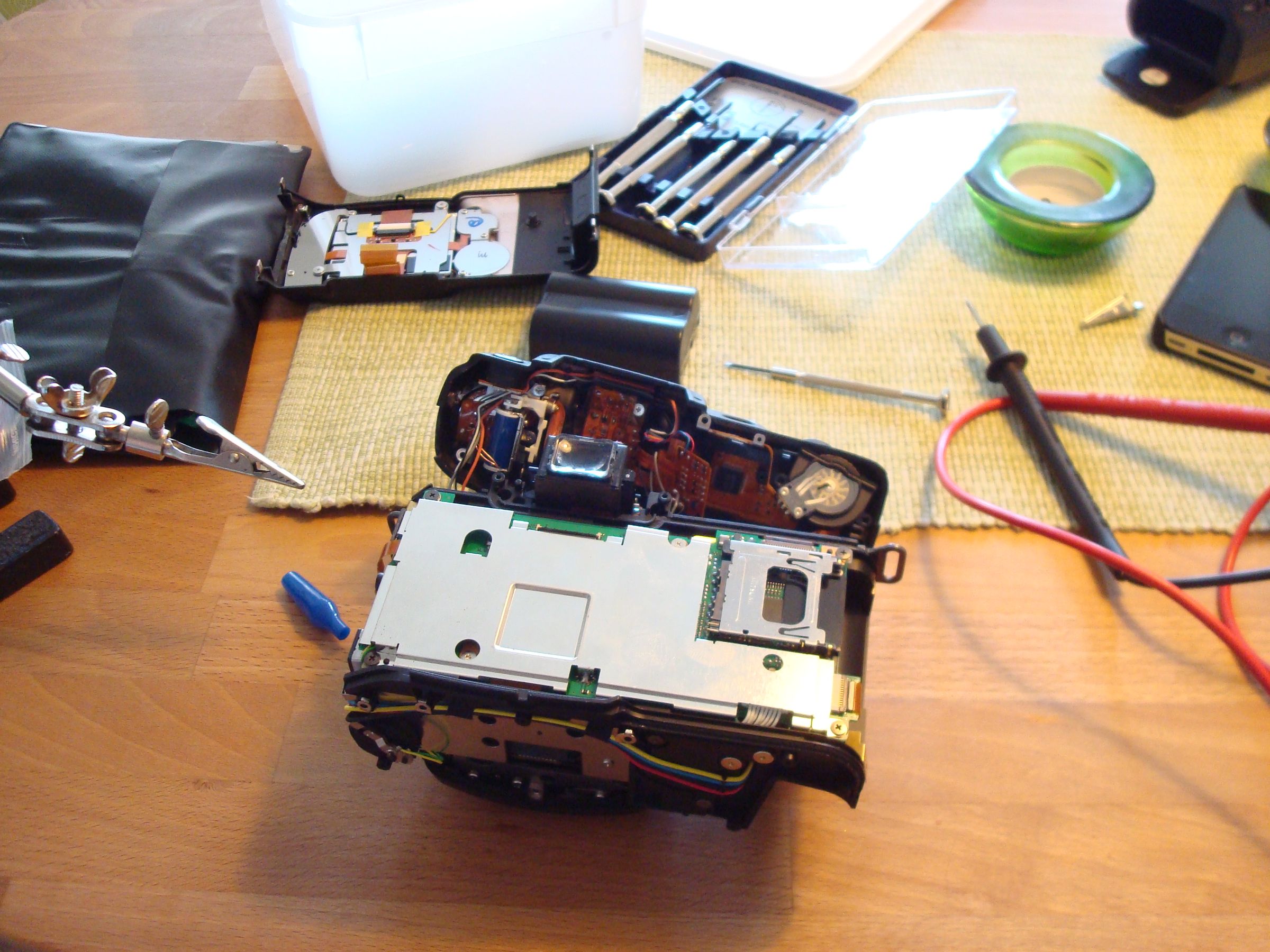

Introduction: Battery-grip Mod for the Nikon D50
This is a modification I did along with my mod ”Adding cableremote for Nikon D50”
Because my D50 only had IR-remote capabilities, the battery-grip’s only way to interact with the D50 was with IR. It was a ugly way from the start, with a IR-emitter that you had to eject from the shell so that it stuck out from the grip and could send IR-signals to the IR-receiver on the D50.
When I added a cable-remote port for my D50 earlier, I also put 2 wires down the battery-tray for this mod.
This is how-to is about making a cable-connection between the battery-grip and the camera thru the battery-tray.
