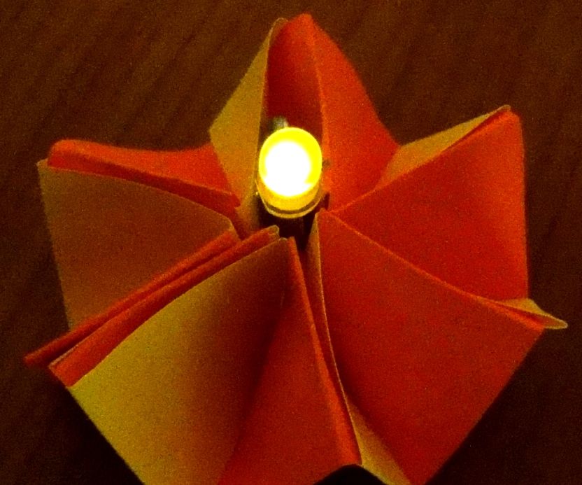

Step 1: Sketch the Battery Holder on Paper
Draw and cut out a rectangle 4,5 x 3 cm.
Divide it into six squares. Number the squares according to the picture.
Notice that the numbering on the side A goes from left to right. On the side B, the numbering goes from right to left.
Draw blue and red rectangles, they will help you to place the conductive tape correctly.
The width of the rectangles is 5 mm. On side A, their length is 1,5 cm.
On side B, the length of the blue rectangle is 0,5 cm. The length of the red rectangle is 3 cm.
Step 2: Cut Copper Tape and Attach the Strips
Prepare two strips of copper tape - "red" strip with length 4,5 cm and "blue" strip with length 2 cm.
Tape the "red" strip on side B. Start at the edge of square 5. 1,5 cm of the strip should remain untaped.
Bend the strip over the side and tape the remaining part in the square 2 on side A.
Tape the "blue" strip on side A. Start at the edge of square 2. 0,5 cm of the strip should remain untaped.
Step 3: Fold the Battery Holder
Place side A on top. Fold the right column (squares 3 and 6) and place it on top.
Fold the left column (squares 1 and 4) and place it on top.
Fold the bottom row (square 5) and place it on top.
Step 4: Finnishing Touches
Tape the remaining end of the "blue" strip.
Your battery holder is now complete. A battery can be placed inside the "pocket" with copper strips.
